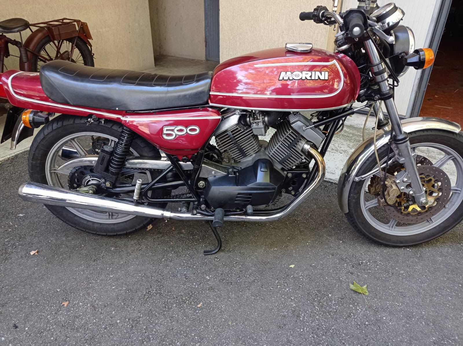

Interesting front brake conversion spotted on facebook
moto morini 500 brakes.jpg (410.47 KiB) Viewed 148 times

Dickyboy wrote: 19 May 2025 07:46 Interesting front brake conversion spotted on facebook
Excellent!
