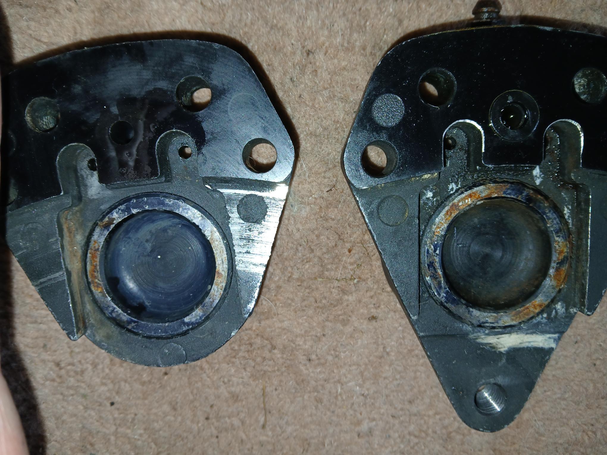

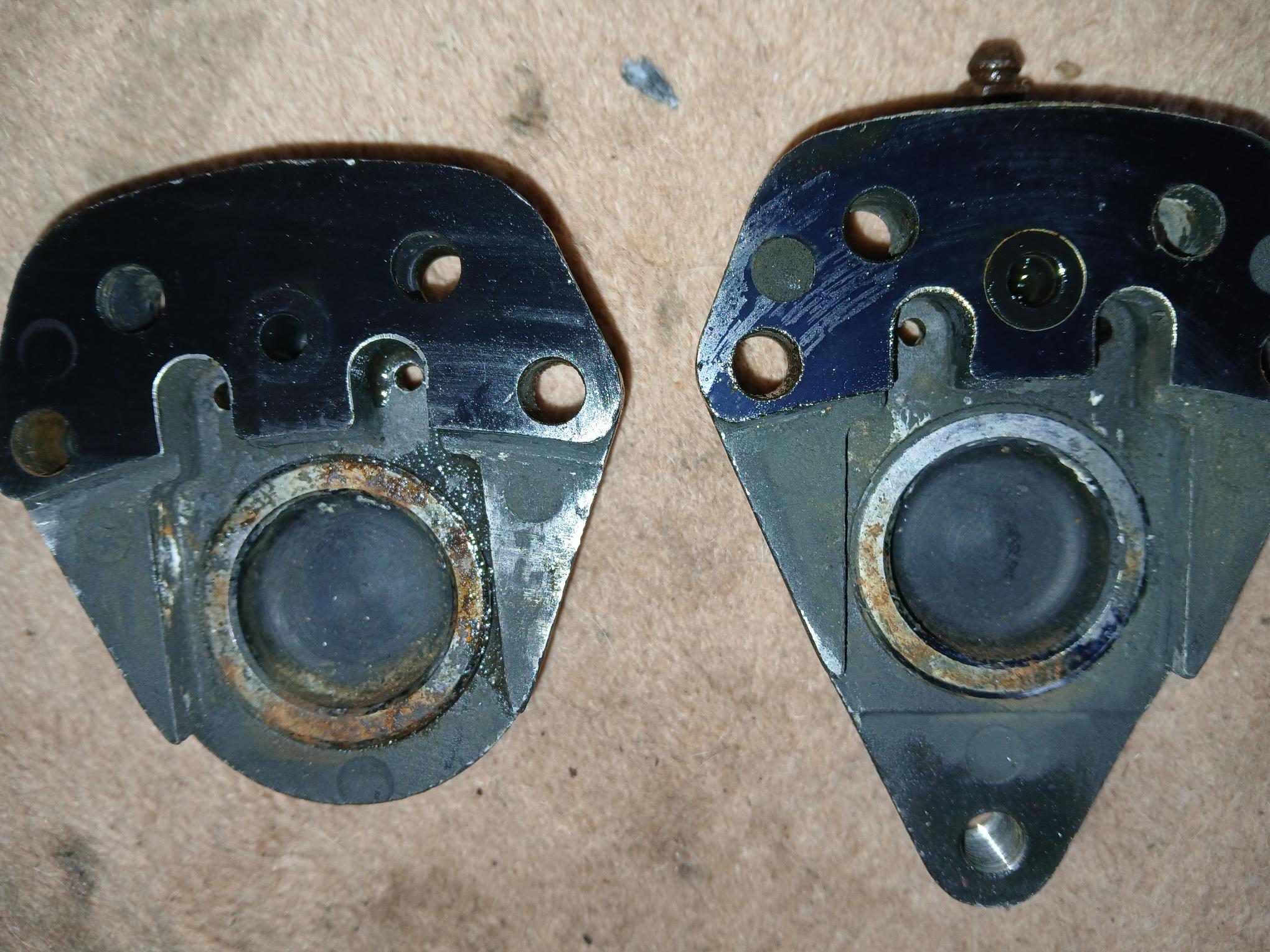

Thanks to all for the tips earlier on at the Ace, much appreciated. It seems both inner pistons had stuck (all the way in) which would completely explain disc wear on the inner facings as they are pushed against the caliper and also the low speed brake judder.
I've taken the calipers off and split them, you can see evidence of disc/caliper contact.
The next task is to unstick the stuck pistons and I would appreciate any tips as to how to do that!!
Thank you.

I am frustrated with the calipers. I thought the brakes would be the easy bit which is why I left them til last!
Anyway, where i'm at is that the pistons are sticky and 2 of them are stuck in.
I've tried to get them out and I can rotate them but not remove them although one of them is half out.
I've spent hours on it and much as I enjoy the satisfaction of fixing a problem i sometimes reach a point where I'd rather pay someone else to do it.
If i could just go and buy some replacement calipers i think i would but failing that does anyone know anyone who does a caliper rebuild service please.
Tim

Compressed air of the nipple, try rigging a bicycle pump. You will need to reassemble first.
Have you tried heat?
Soaking in penetrating oil?
Arthur Farrow
Posts: 95
Joined: 24 May 2008 09:09
Re: 500 Strada front brakes.........
Post by Arthur Farrow »
I bought a VERY cheap Chinese master cylinder and used paraffin as a medium (brake fluid would be messy) to move the pistons out on the bench...simply put the master cylinder in a vice and pumped. Worked great
