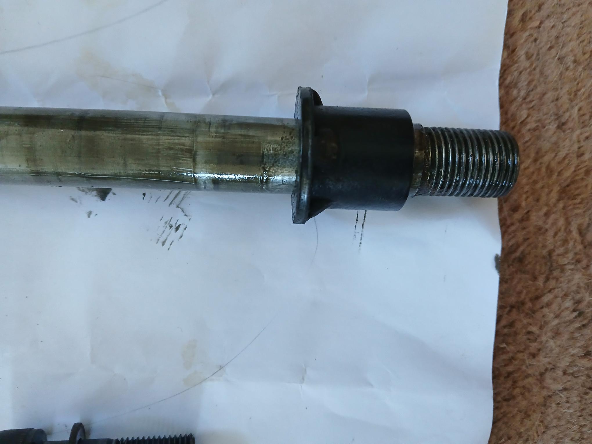

I took the front wheel off to take the discs off and the spacer dropped out and i just
wanted to check it's the right way round before refitting please (photo attached)

Whilst my bikes are older with a different spacer, Engineering logic would suggest that the large diameter side would go against the fork slider and the smaller diameter would go against the bearing.
Hope this helps,

Cheers George
