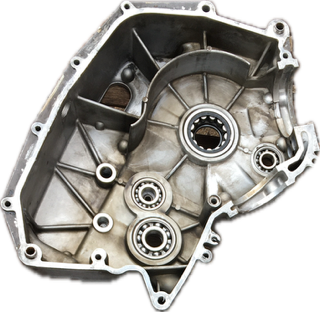

I have a picture of a crankcase albeit a 350 showing the dowels
Crankcase half with dowels in situ

Thanks 3potjohn,
I knew where the dowels go, it was all the measurements that were doing me in! Trying to make sense of not enough information. Steve Brown has set me on the correct path.
