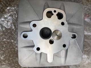

Ive found someone to repair the crack in the front head (£150 + VAT approx), The rear head has the very beginnings of a crack and I'm pondering whether to ge ahead with both. Valves and guides may also be needed.

That looks like a good repair, bearing in mind I have not seen the inside of mine yet. Where did you get it done?

thanks John
Ben Hobbs at Auto Engineering Chard Junction Somerset did the work https://www.autoengineeringchard.com
