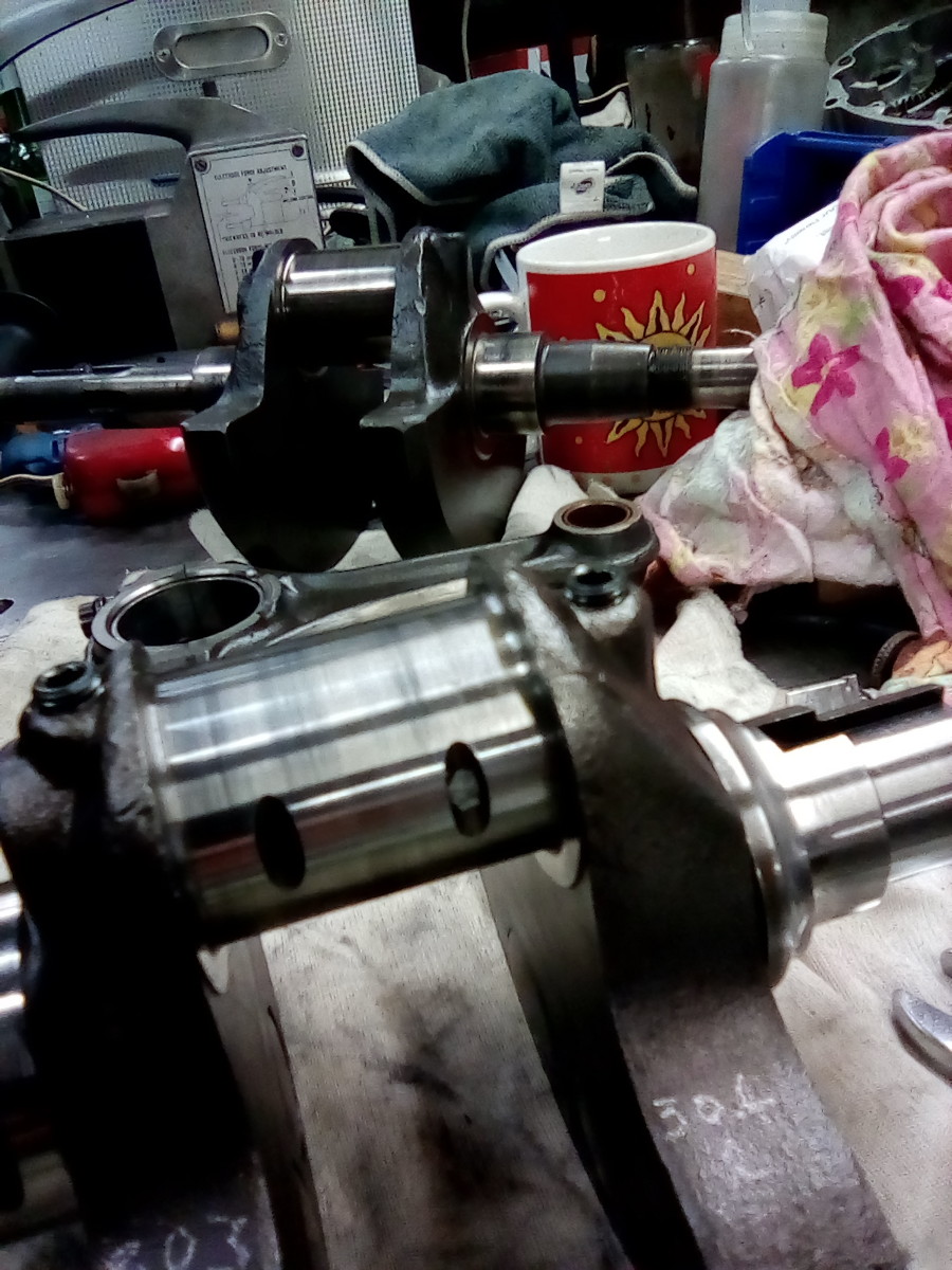

An update for the 5 speed 500's engine. Rebore has been done, and the crank inspected. Some crankpin wear and the big end bearings not in good shape. Fortunately there were big end undersize shells available for purchase from Mdina. The crank should be back soon after machining the pin for the new shells.
I thought it may be of interest to folk to see rare pics of Morini and Ducati Pantah 500 crankcases and conrods side by side in the shop for comparison.1st photo is the Morini crank showing the wear and the Pantah crank in the background. Still a bit to do before the engine will finally be back together in the frame and the red bike start looking like a bike again.

Hi Vitesse. The engineers and other people on the forum are better qualified than I to comment on the differences. Going by what the engineer working on my engine said, I can comment as follows:
He was quite impressed by how similar the size and layout of the cases were, even wondering if Morini had copied Ducati. I did mention that the Morini cases evolved over 10 years before the Pantah (dont know how bevel cases would compare though).The top case is the Pantah's left half, with the 90 degree V compared to the Morini 72 degrees.
Overall the Ducati cases were a bit thicker in structure but had a similar reinforcing rib pattern especially round the opening for the front cylinder. Cylinder bore was a bit wider for the Pantah, and there is an extra hole in the upper rear region of the Pantah cases where the swing arm goes through and supports the engine. Camshafts are in between the V for both bikes. The right side Pantah case had a roller bearing for the crank, instead of the Morini plain bearing.
Conrods differed several mm in length ( I will look again re which is shorter), and the Pantah conrods had a bit more thickened edges including round the eyes for the small and big end bearings. Though the Morini revs a couple of thousand lower, he said the conrod was still a high performance rod for a street bike.
The Pantah's crankshaft pin was thicker (42mm I think? versus the 35mm plus a wee bit for Morini), and the vertical plates ("cheeks"?) supporting the crankpin were of higher quality/more expensive forged steel, compared to the Morini cast cheeks. You can see the different finish of the dark cheek metal in the photo. When tapped with something metallic the Pantah cheeks rang clearly like a bell and the Morini cheeks sounded duller. Interestingly, the Morini cheeks had 2 round balancing weights embedded in them but the Ducati did not.

park3164: you are making good progress with your Morini.
The Morini 500 has a bore and stroke of mm 69 x 64; the Pantah 500 is mm 78 x 58, more over square than the Morini (over square meaning that the bore is greater than the stroke). The Pantah would rev higher, which helps to make more power and a faster bike.
Another similarity between the two is the use of a belt to drive the camshaft (one for the Morini and two for the Pantah). Morini must have been an early adopter in the use of belt-driven camshafts. The Morini 350 was praised for its advanced design features. It is a pity that the Morinis don't have more effective oil filtration but some Morinis seem to rack up big miles without need for a rebuild.
I don't think Morini copied much from Ducati; a tighter angle between the two cylinders resulting in a more compact engine, push rod operated overhead valves v. overhead cams, the belt-driven camshaft.
