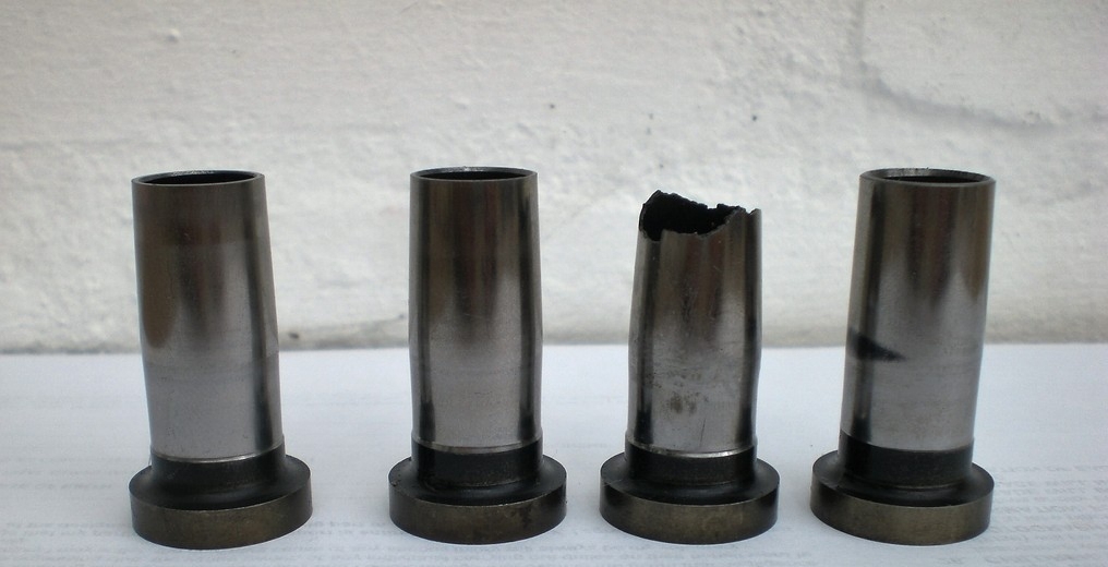

Cam follower photo as promised
cam followers
cam followers

:shock: Never seen a follower like that. This surely has nothing to do with the oil.

Those are truly horrific!

Unbelievable.
One for the black museum...
Begs the question ; What were the pushrods like? At some time very bent or very broken..

Pushrods are fine, however the gudgeon pins had very bad wear on them, one big end shell has turned and shagged the crank, it is looking like a lubrication issue. Pump or oil I am not sure, will probably change both.

That is not wear, that is catastrophic failure, possibly caused by heat. As you do not know the bike's history, could a previous owner have let the oil run low or not changed it for a long while? Nothing wrong with Halfrauds 10/40 semi, in my opinion, if changed every 2.5 k miles / 4k kms.
When I was running my Strada 40 miles per day commuting plus other rides, I was using GTX 20/50 with changes every 1000 miles. The engine was perfect. I think the halfrauds oil is probably a better quality than the original GTX.
Low mileage, frequent short runs and not warming up an engine are probably the biggest problems for an engine. Starting a Morini on both chokes always worries me!
