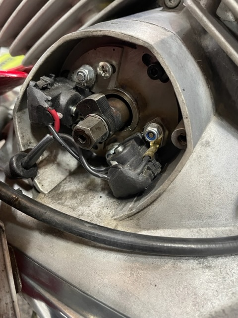

by Stempy
Traced no spark to faulty L/H pickup, anyone have a spare?

by mbmm350s
I have a box of spares of these all of which have the similar problems after usage, impossible* to adjust to the tiny clearance needed and one of both of the coil packs is loose, so I would advise not to use, but replace as Steve says with the Luzzi pickup or with a Sachse digital system.
You can mail alexluzzi@gmail.com, in English, and he will help with the pickup and transducers.
*yes some people have been able to get them to work reliably but too much time and effort is needed.

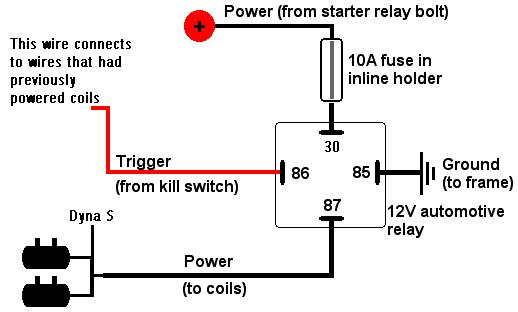

by Stempy
Some great information , one thing to consider is to fit a relay to negate the old wiring and use the old coil wire to trigger the relay then you will get the full 12V feed

by MickeyMoto
Stempy wrote: 23 Apr 2024 06:30 Some great information , one thing to consider is to fit a relay to negate the old wiring and use the old coil wire to trigger the relay then you will get the full 12V feed
This is my next project after I have road tested the bike. I only have 0.1 volts drop from battery to coils at the moment, but more testing required. I took the +12 volts from the switched 12 volts at the fuse box and used the block under the front of the tank as a connecting point for the SWF loom. The system is designed to use the fuel tap supply at the block. I can easily fit a relay into the system. I also fused the system as the fuse behind is the fuse in the cylinder.
Maybe a diagram is required! The kill switch, obviously, is now back to front- off is on and run is off. That'll confuse the buggers!
