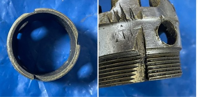

In the first instance, save yourself some money by modifying an old exhaust nut to do the job.
Photos of mine attached- cut into the thread at 90 degrees in 3 places around the nut and then file a lead in to the new edge.
Will do a pretty good job of cleaning up head threads and significantly reduces the risk of cutting a cross thread which you might do with a tap.
Obviously if the head is really mullered this won’t help much but then a tap probably wouldn’t either, unless you’ve had a insert welded into the head and need a completely new thread (at which point you may as well use an expert like Paul Compton to to do the job for you)

Of course I’ve just re-read your post and realised it’s the nut you want cleaning up not the head… but the above info may still be of use to others

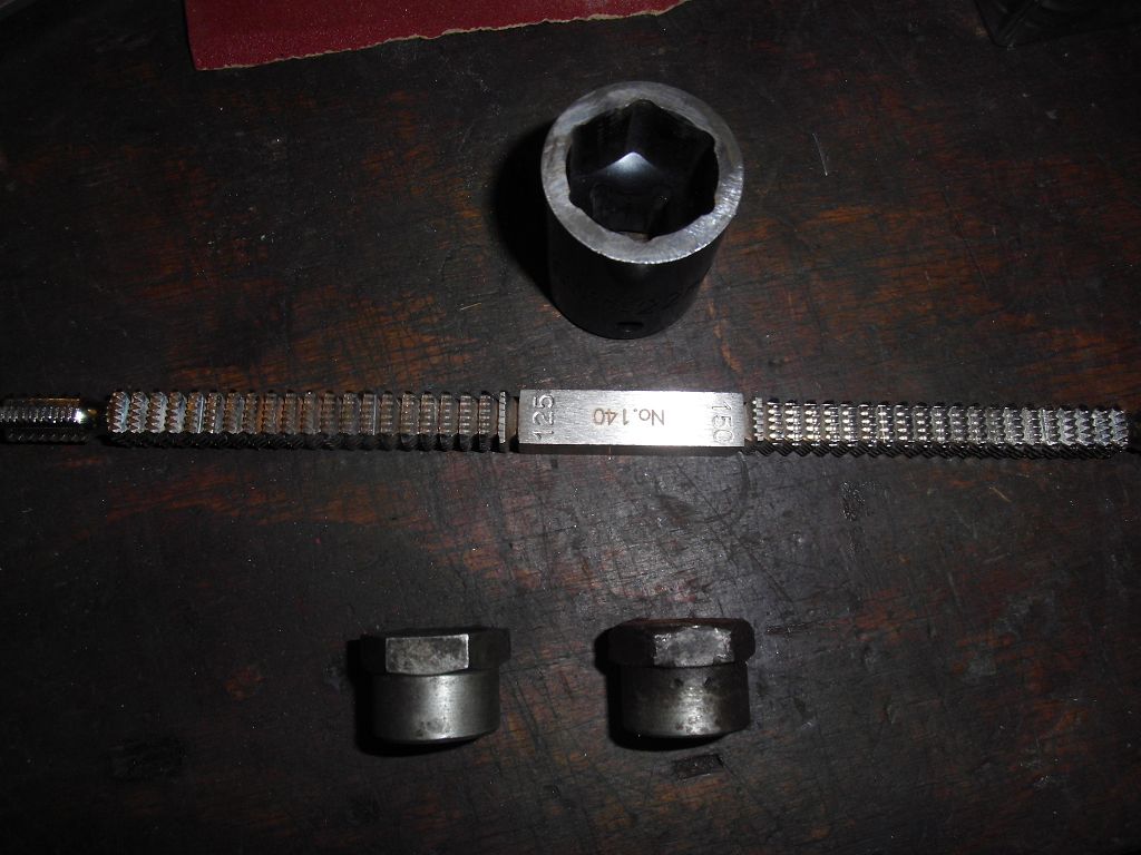

The easiest way trying to save a nut would be a thread file, a very useful tool anyway
