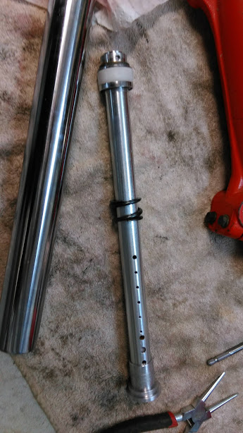

Is it the long version of the very first series? If not you can try internals from an Excalibur. The second and third series have fork tubes with the same length. I have fitted them to a Camel once. Only thing is that the tube wall (if I'm saying this right) is thinner so don't do very high jumps ;)
See this pic, the lower parts are from an Mk II Camel the top ones from an Excalibur. Hope it helps.
