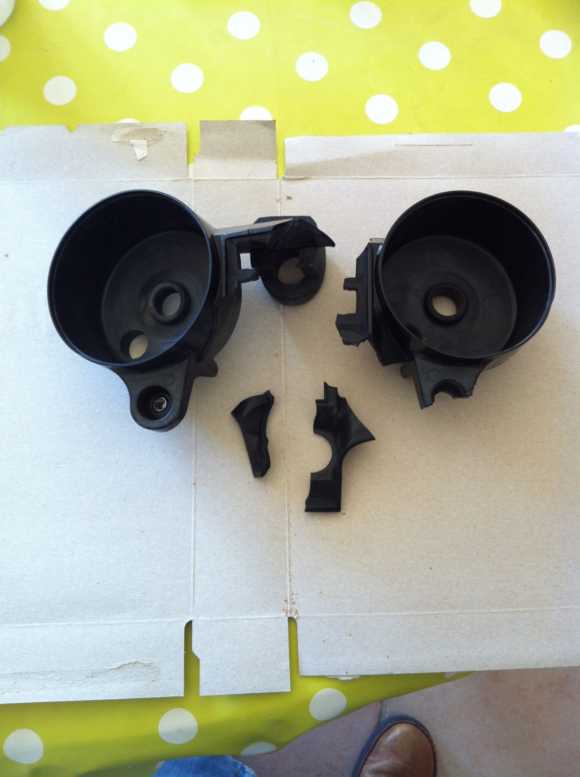

Hello everyone, out on the old 125 H (1976) today and hit a pothole and the speedo and rev counter holder snapped in two, has anyone got a spare that they won't to sell ?

No - but I recently reassembled an instrument console using Q-Bond and it seems to be OK. Worth trying if you can't find a complete one.

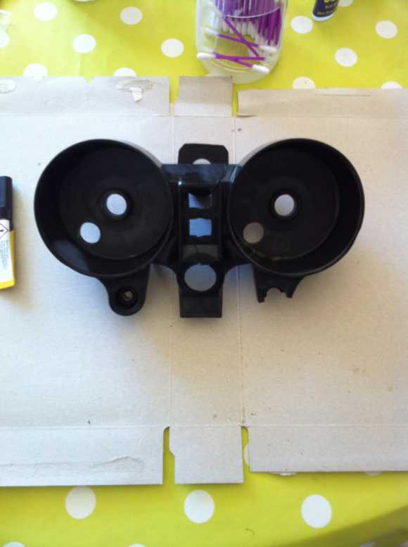

Here's what I had and how it ended up (though the mounting bracket was fixed too. It sets so quickly that you can use insulating tape to form edges, etc. Just ensure you have a good seal or the powder drops through.
