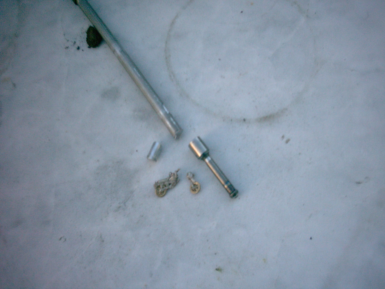

In 2004 on the way to a concentracion suddenly the rear cilinder stoped working. Did the usual things: taking of the camara of the Dellorto to see if gasoline arrives and a look at the spark. Everything ok. I took of the gasoline pipe of the rear and decided to carry on instead of going back home (the concentration was only a 100 km from home) thinking that the problem must be about the valve sytem. When I first stopped to look after the bike I was a little scared, because in the dust under the motor I found a pendant: a broken motocycle :shock: This looked like Voodo to me!
At the concentration I foud this: a broken pushrod. As you see it broke exactly where the alloy part gets out of the steel part.
Twoo weeks before I began to notice a strange high pling-pling sound at idling. There are so much noises with our motors :lol: that I decided to ignore it, because I could not find the reason. We had great fun to get the little alloy part out, because during our intents it fell down in the cup for the push rod :roll:
I changed it and never had problems with the pushrods again. I think it ist not a constructive problem but just bad luck. To me it looks like a infringement that took its time and finaly has broken. Probably it happened because the twoo parts lost their fixed conection. The pushrod fell apart and did not make any noise.
Once my timing belt broke. My fault because I put one of which I didn´t know how old it was, waiting for a new one. It broke at about 160km/h on the highway. The result was a bended valve, nothing more :P What a great motor we have! Thanks to Lambertini!!! Obviously braking the belt with the 350 motors the usual thing are bended pushrods. Happening with a 500/501 (in most casas the outlet one) valve is bended
