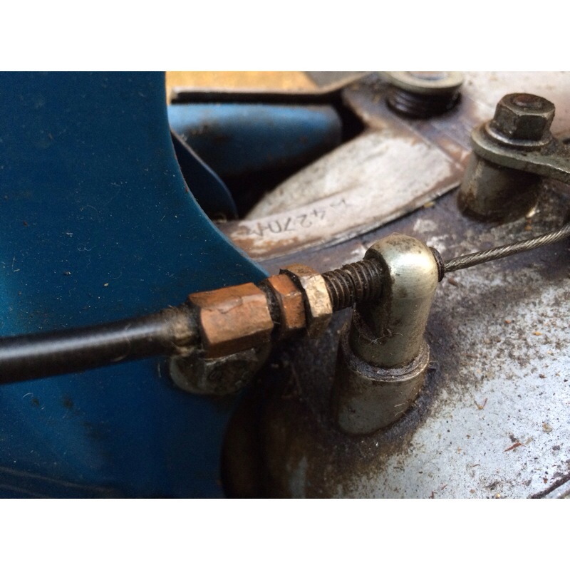

Basically I just got a 63, Kerry Capitano with a 48cc FB Minarelli engine that's been sat since 1967.
The gear cable needed some adjustment but as I went to turn the adjustment screw it basically just snapped, so now I really need a new adjustment screw which I'm hoping won't be too hard to find. Would love to know if anyone knows of where I can buy a screw for one or if another screw fits from another bike?
I've attached some pictures that I HOPE work.
Any help would be brilliant!

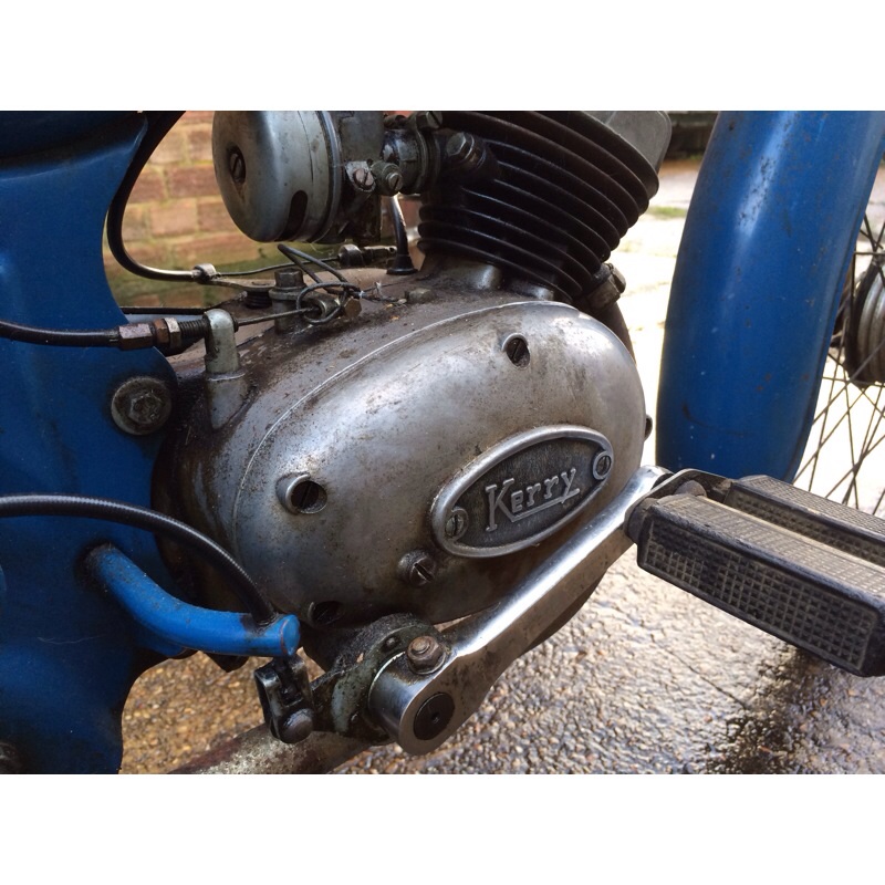

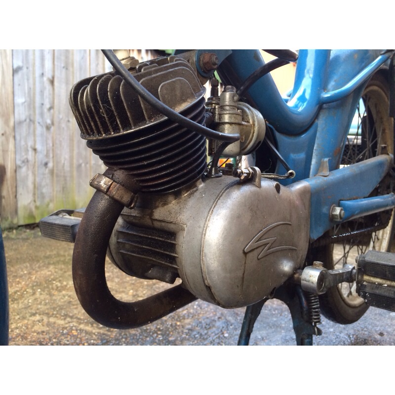

Engine views
Engine views
The other side, not sure what the engine is actually called?

do you have any measurements?

hendre wrote:do you have any measurements?
Hi, it's a 10ml head, 2cms long and about half a cm thick

I think the size that Hendre meant is the thread diameter. From the pics and your comment above I would guess that is 6mm? The adjusters are normally fairly standard (within a couple of sizes anyway) So my guess is a standard 6mm diameter with 1mm thread pitch. If you take it out you could take it along to your local friendly Kerry dealer :D or failing that a cycle shop/old fashioned motorcycle repair shop. They may well still make up cables and hold a stock of fittings like this.

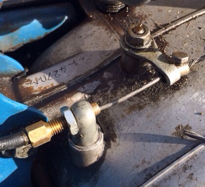

Many thanks to everyone for your help. Managed to get a 6mm adjuster in there after re-tapping the thread!
Now all I've gotta do is sort out the gears because it's really hard to get it in to first gear! (Handlebar gear change :(
