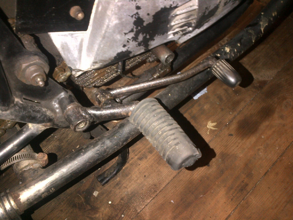

I'm also after gear pedal / foot rest and linkage for the same bike, current one is very warn and sloppy. I've attached a photo as all the photo of stardas I've looked at appear to have a different setup with the pedal attached directly to the gearbox shaft.

For the linkage, just buy two 6mm rod ends (like these)
http://www.ebay.co.uk/itm/M6-Female-Rig ... 1c31f423bc

Thanks for that EVguru. I've also found a friendly machine shop that will bush the gear pedal. So combined with the rod ends that’s the gear selection sorted.
