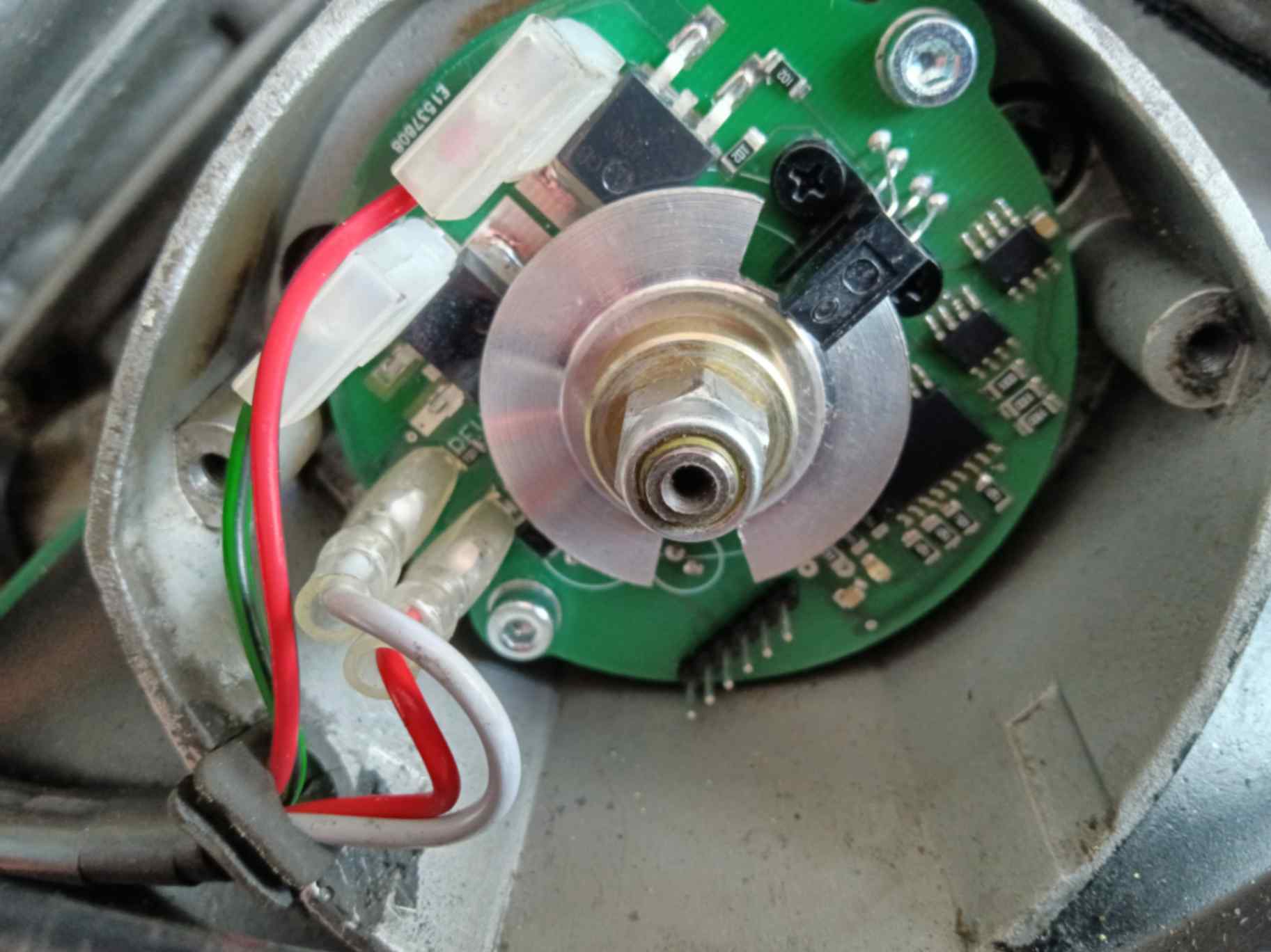

Steve, I agree with the rotor problem. It would be better to use the existing key on the cam and slot the circuit board. The ease of getting the timing correct (set pms1 on compression stroke and turn rotor until red light extinguishes) but holding the rotor whilst tightening was a problem.

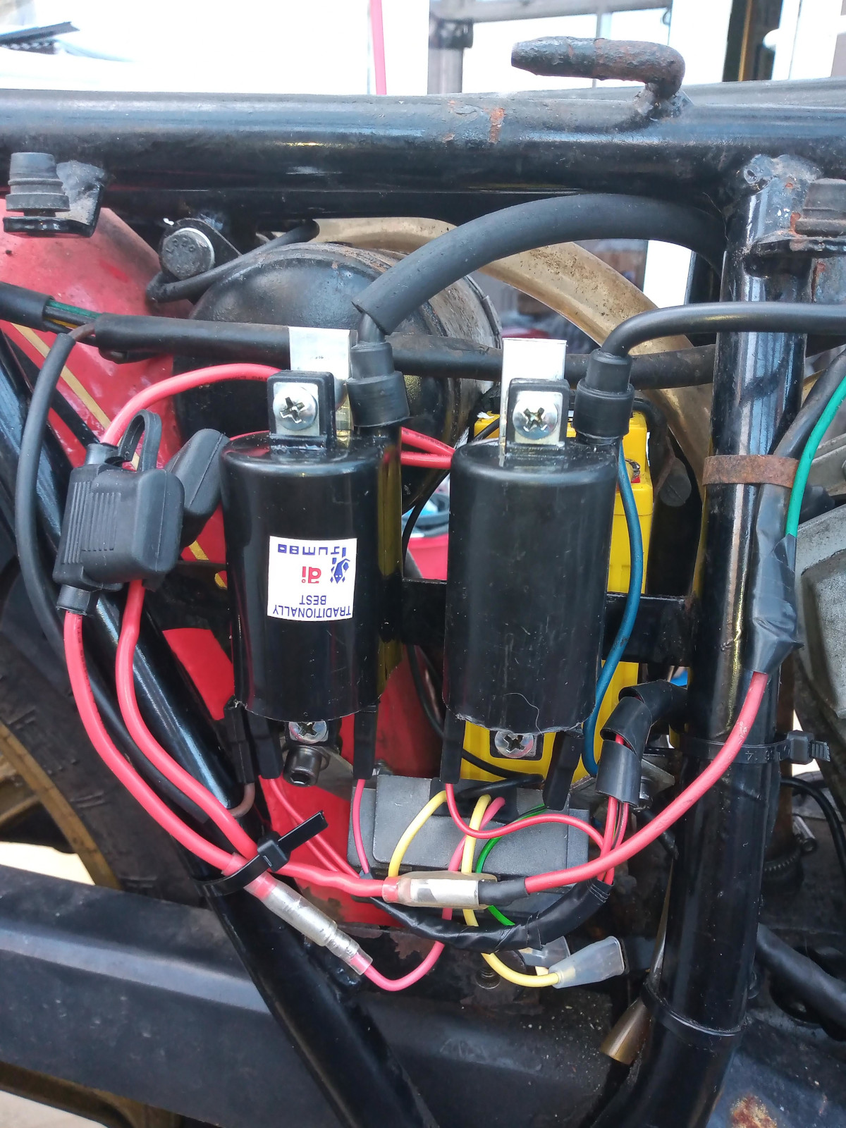

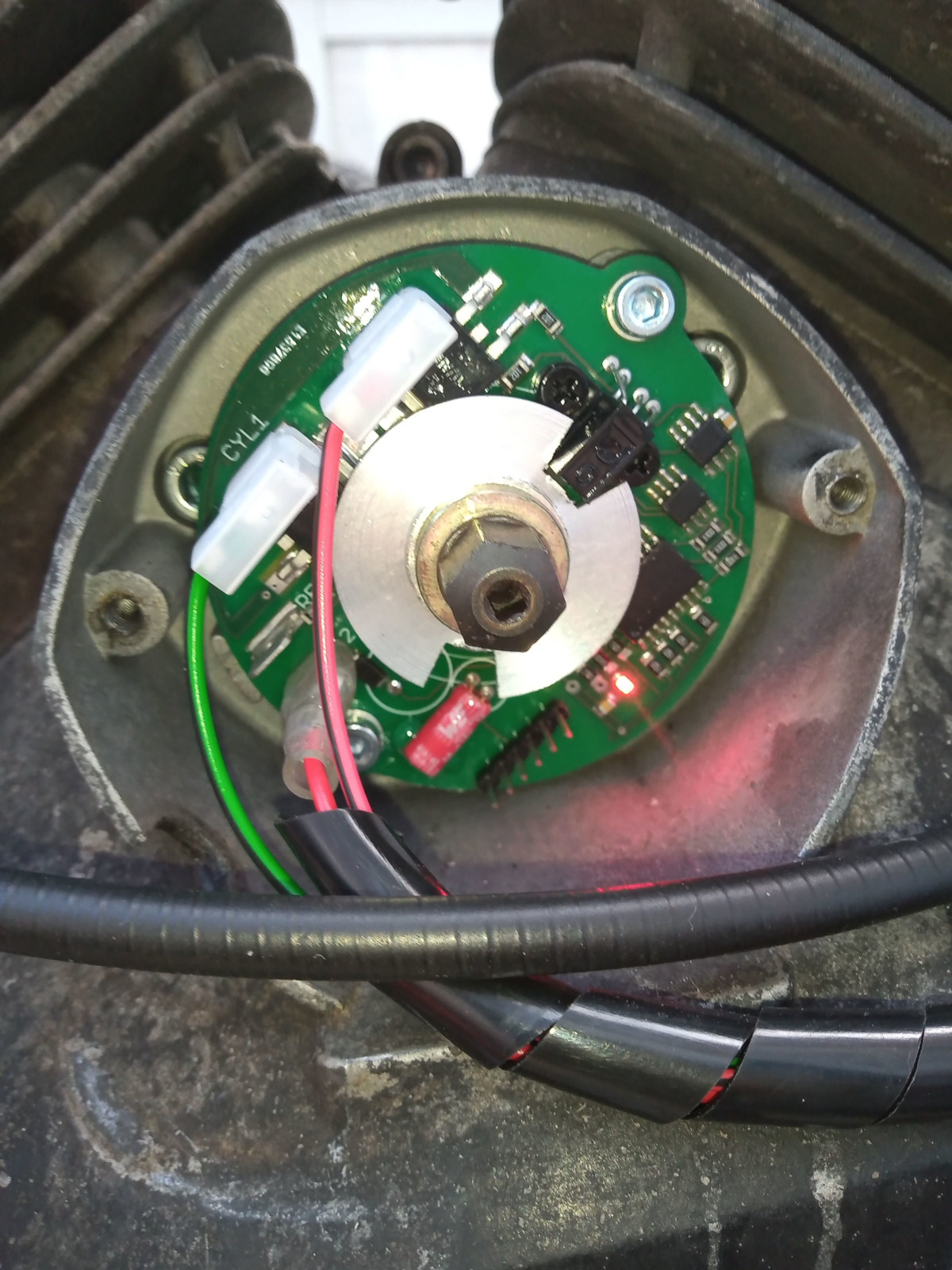

The first photo shows the circuit board and the rotor at TDC (approx) on Cylinder 1. It is timed to the trailing edge of the cutout on the compression stroke.
The second shows the coils and the grey wire to the tacho connection.
One thing to note is that I have used the washer and the nylon from the original system. The SWK comes with a new M7 nut and washer. The washer was not deep enough to alow the nut to tightened down on it, instead it tightened to the end of the camshaft. The nut was a plain nut, too, and I wanted a bit more security than that.

Mickey your rotor is different at least-I can't say about the circuit board except to say I'd still prefer that to be adjustable. He must have upgraded it a little. Keep us posted on how it performs longer term-Barry too please!
