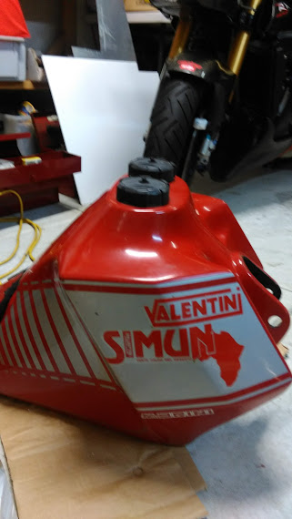

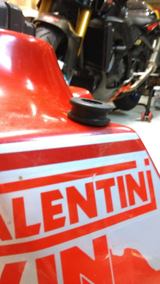

I'm sorry I didn't realize the other bikes had different mounting systems. The Camel has a rubber grommet with a steel sleeve. I bought some grommets today but they are not quite the right size. You can see I have a Valentini tank I want to fit. The tank is 6mm thick where the grommet fits in. So normal ones are no good. The shop only had one wide one. Will try different shops tomorrow.
Seems I cant attach pics. I will once quota of attachments is lifted.

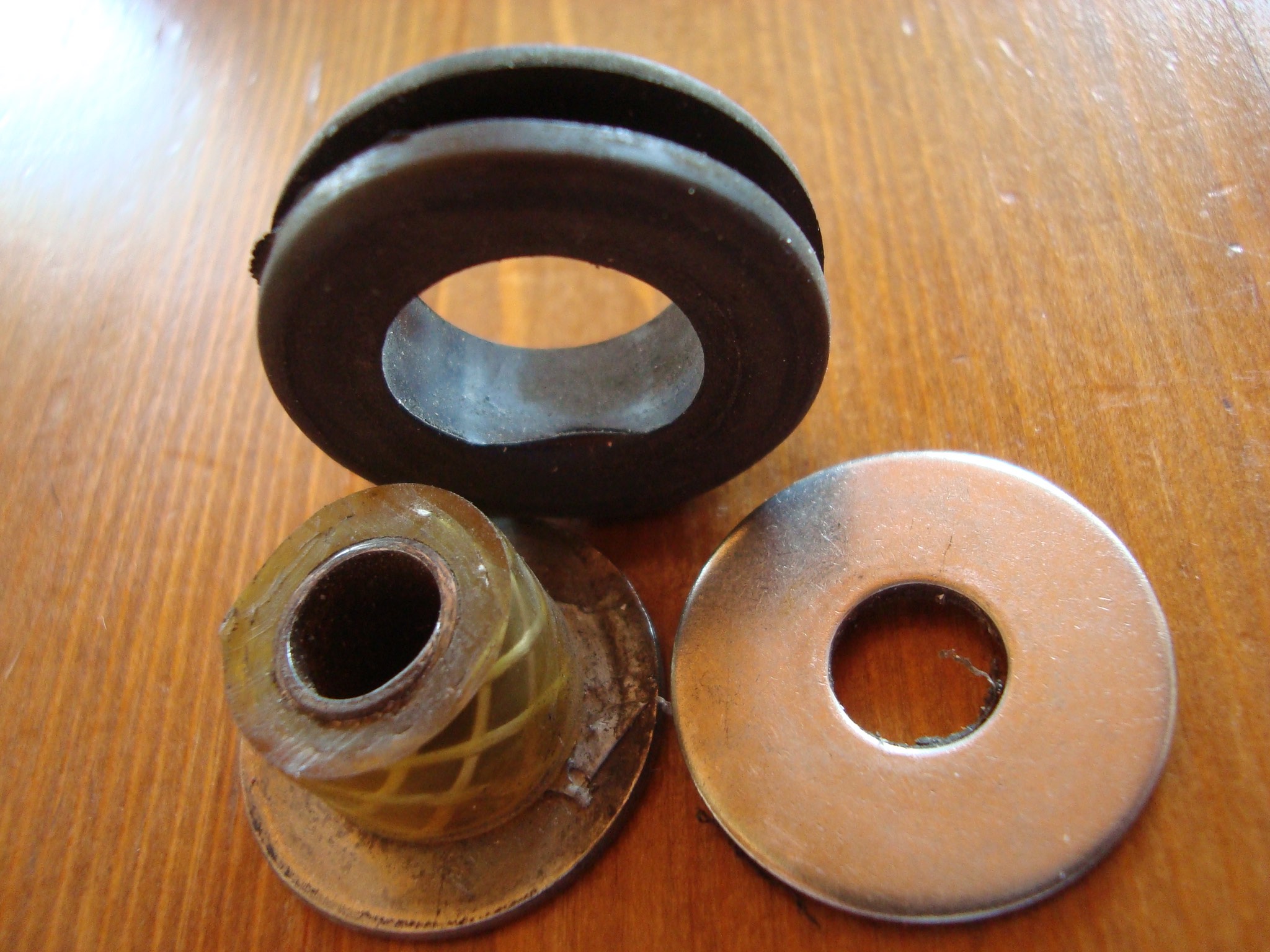

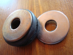

I'm posting this and these photos on behalf of Ian who encountered some problems doing so.
In Ian's words:
Hi,over 10 years ago I bought a non running Camel with the front tank mounts missing.
I ordered a set from NLM but all they could supply were the M7 bolts.
I then discovered that one of the frame mounting threads was damaged so I drilled and tapped the frame for M8 bolts and made up mounts from stuff I had in the workshop.
Later I silver soldered the tube to the washer to form a top hat which made fitting the tank far easier.
Original photos from Ian
Camel Tank.jpg (472.03 KiB) Viewed 7364 times
Camel Tank (1) web.JPG (43.08 KiB) Viewed 7364 times

Thanks for those pics Julian.
I tried everywhere yesterday to get some grommets that fit the Valentini tank. I gave up and ended up elongating the holes in the tank a few mm so the easily available grommets I had would fit. Now I just have to reposition the throttle cable splitter and perhaps the coils so the tank will slid on. Then I will see if the standard tank steel grommet inserts will fit, or I make some more.
