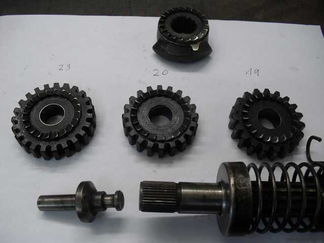

I can confirm this:
- 19 teeth: 500/501 6-Gear (the only one with somehow "pointed" teeth)
- 20 teeth : 350
- 23 teeth: 500 5-Gear and 250T (as far as I know, the whole gearbox is identic)
The upmost sprocket on the kichstart shaft should be carefully chosen to fit the teething (there are slighty diferences concerning the form of the junction teeth!)
The rest of the kickstart mecanism is allways the same at least in 350, 500, 501 and 250T
Primary gear:
350: 29/66
500/501: 31/63
both are 23 mm thick
