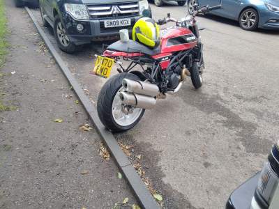

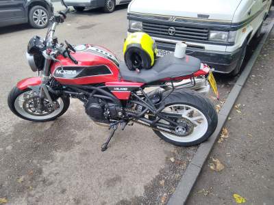

MotoHub does one in carbon.
I have made my own as a proof of concept. The frame has screw holes at the rear for the pannier frames. A secure fixing point.
- Posts: 2730
Re: Tail Tidy?
Two pieces of fence strap, drilled 10mm, bent and sawn. Attach to frame at rear. I bought a tail tidy for a tenner. Unfortunately, too narrow so two bits of metal bolted to the fence straps to get the width. Fitted the number plate light and the reflector from the existing unit. Pulled wiring from swinging arm and routed under mudguard. A bit Forth rail bridge but 45 miles later still attached. Angle of dangle of number plate can be changed. Probably will throw crap up my back. Need to file out bolt holes on numbernplate bracket...
Will replace brackets (£2.50 for a selection) with a piece of 5 or 6mm aluminium plate and replace bolts with countersunk heads.
Bodgit and Scarper (very) Ltd...
