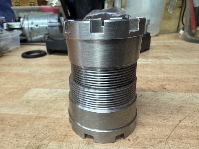

I bought one of these to replace a chromed/bronze one that had to be destroyed to remove it. It only screws in about halfway, and then sticks. I've tried on three different heads, and it's the same on each. My remaining Bronze collar screws in just fine. Do the bronze collars wear, making them easier to put in? Or are the thread sizes variable on stainless ones? ~Or are they simply tight because they are new?
All advice gratefully received

It suggests that the thread is not parallel on the stainless nuts. Can you measure the thread diameter at the beginning of the thread and closer to the plain section? This would give you a clue as to why it is jamming.
The other scenario is whether the thread pitch is correct or not. Laying your 2 nuts together and holding up to the light should show if the pitch is correct or not.

well, that nuisance. it appears the stainless one is about half a mil wider than the original. I have a bloody expensive paperweight, then

Could it be for a 500?

are they bigger by that much? It was sold as for a 350

From memory 350 are 42mm and 500 are 45mm the castellated head sizes are also different

the old one is 42mm. the new one is 43mm...

Are you sure, that stainless esxhaust collars are the adequade material to insert in our heads?
I have a brand new pair of them since years. But building up Dulcinea I decided not to use them. Maybe with ceramic or copper paste it will do, but in my opinion this cobination of material is not the best choice :roll:

tbh i was wondering that myself. I've been using high temp aluminium grease on all the stainless bolts i've been using going into alloy, but that thread on the head looks awfully vunerable. I think i'll search for a proper one, and possibly get this one turned down a mm in the meantime

interesting points about Stainless collars, which i had considered (i was going to use aluminum grease) and decent replacements are unobtainable...
I'm now looking at lengths of brass tubing... i could get 100mm 50mm tube with a 35mm inner diameter for about £40 . then i just need a machine shop to cut a thread onto it...
