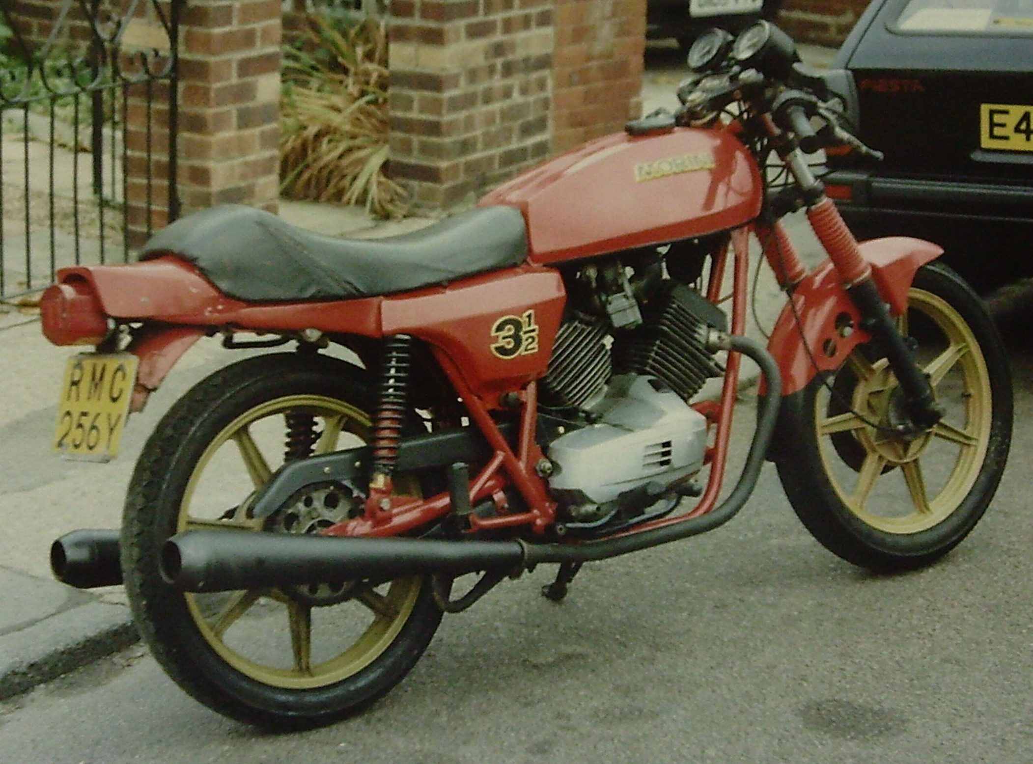

Just to amuse this photo is of the 350 sport I got in 1983, just before I sold it to a friend in 91. A man in his twenties (me), mostly only transport and no money to look after it properly (serviced well, but cycle parts suffered).
