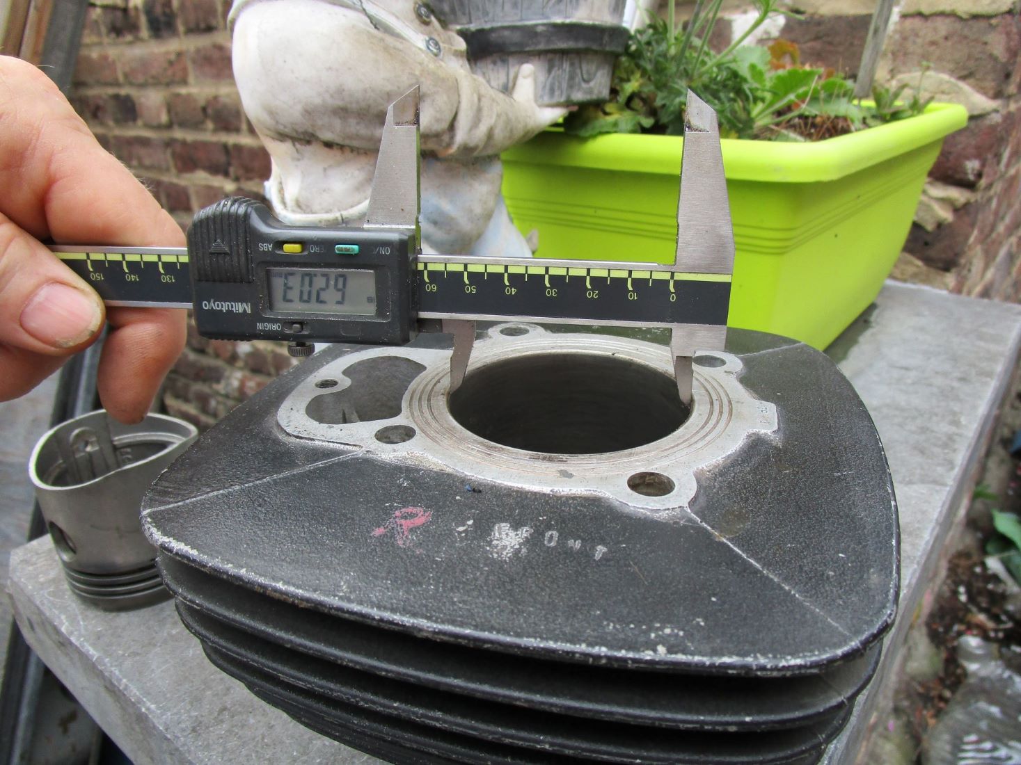

Hello ,
One way to know the size of the piston is to measure the inside cylinder with a caliper . Standart is 62mm when 62.2mm it is the first oversized and than if 62.4mm that's the second oversized and the last one is 62.6mm .
Christian , 123 .

Hello ,
As I said in my former message if you measure the Ø of the cylinder you have the answer .
If the Ø is 62mm the answer is std .
If the Ø is 62.2 the answer is +0.2 .
If the Ø is 62.4 the answer is +04 .
And if the Ø is 62.6 the answer is +0.6mm
This cylinder is for a standard piston . std .
And here it is a piston 0.2 to fit in a cylinder with a bore of 62.2mm
Christian , 123 .
