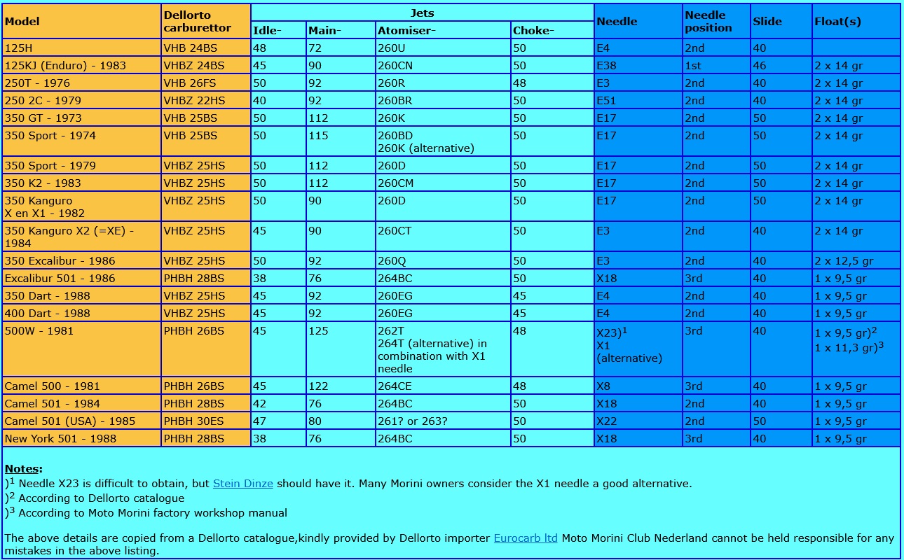

What are the correct main jet size for my 1984 k2 please standard airfilter and exhaust system?

The attached chart would suggest 112.
Carburettor settings Moto Morini models 125_250_350_500cc.jpg (401.2 KiB) Viewed 2541 times

From a previous thread. I run 112 in my K1 which is slightly earlier. I have dropped the idle jets, which reportedly improves off idle stumble, with which I agree. I also believe in keeping things as standard as possible otherwise.
viewtopic.php?p=20980#p20980

Thank you fitted 112 main jets .....now goes much better
