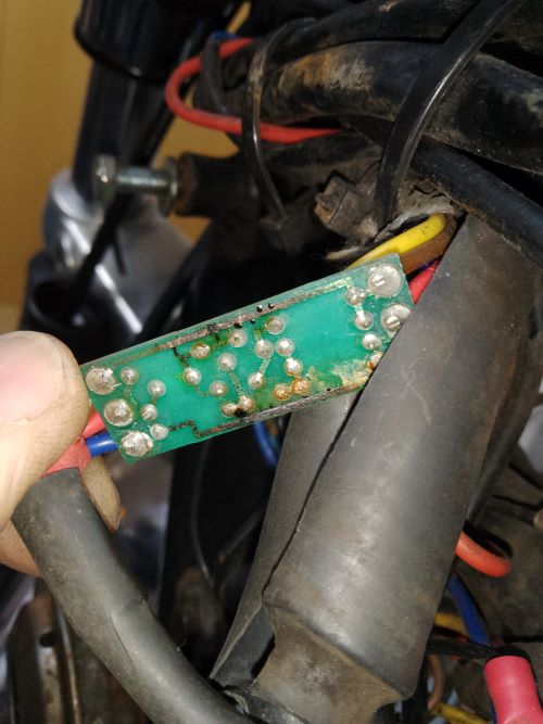

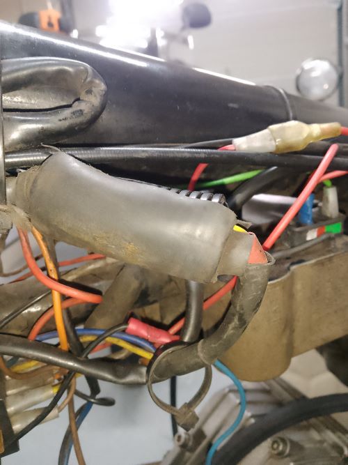

Tracing the wires ,tucked up under the frame I found this
It contained this corroded circuit board
I have had the bike over 15 years and before I resort to trying to adapt a chinese tacho can anyone tell me what it is ,and can it be Fixed?replaced or copied

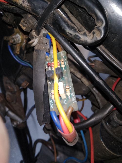

As no one answered the question before, may I suggest that the circuit board may be one of the 'widgets' that used to be sold by NLM to allow the tacho to work on coils/transducers that didn't have the grey terminal for the tacho drive?
Never had one, but know that such things existed. The wires look far too good to be Italian!
Good luck,
Good luck,

My ’76 Strada had electronic tacho and one of those ”widgets”. They were not a complicated circuit and I know that there is a description circuit diagram and pcb design floating about somewhere on the net. A relativlt confident DIYer should be able to build one.

For the relatively small effort involved, I'd give that board a good scrub both sides with a toothbrush and contact cleaner before giving up on it. Dirt and corrosion across the tracks could be enough to cause problems.
My electronic tacho was completely dead until I swapped out the trimpot on the internal board - corrosion of that trimpot looked to be the cause.

An update!
I had the widget repaired and now have a linear response to revving the engine but only to an indicated 5500rpm although it sounds more. I think I am going to have to open the tacho up to investigate further.
Any ideas?
