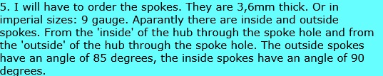

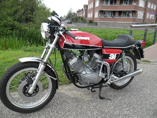

The old Dutch Morini Club website has an article by someone who restored a 3½ Sport with wire wheels, twin discs and Borrani rims. There is a little bit of information about the spokes.
Here is a link to the article...
https://www.morini-riders-club.com/Nede ... oject.html
He sent the wheels to be rebuilt by Haan Wheels in The Netherlands. They may well have the data you are after...
https://www.haanwheels.com/classic-vint ... ls/spokes/
The photo shows the finished result...
Screenshot project 350 Sport.jpg (44.48 KiB) Viewed 5247 times

Hello ,
I have photos of a complete front wheel but I can't sent them on this forum .
The Ø of the spokes are 3.5mm and the total lenght is 170mm .
And the spokes are fit inside an outside of the hub .

Motomat350 wrote: 02 Apr 2025 19:08 Thanks 123Morini
Do you know the bend angles and lengths ?
I think those angles quoted in the reply from Jenny are accurate.
