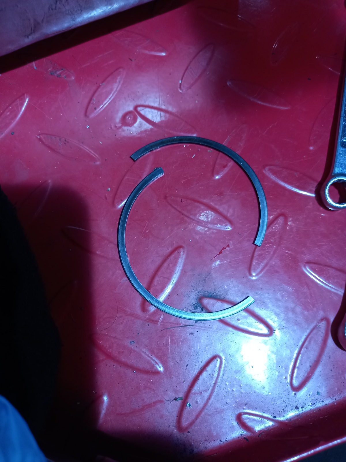

Thanks again, was thinking heat gun and stanley knife, I’m actually thinking about pulling barrels off Today to take a peak at rings and bores, dipped oil Today and it’s down halfway between max & min in 140 ish mile, plugs not oily so guessing it’s thrown it out of breathers
Thanks barney

Thought there would be a problem
