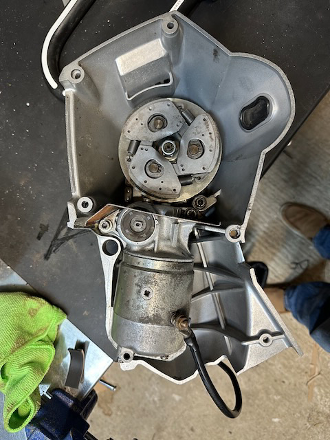

Well all the electrics are working but....
It appears the customs have a different electric start casing, so the gear linkage fouls!
Does anyone have a spare standard electric start side casing?

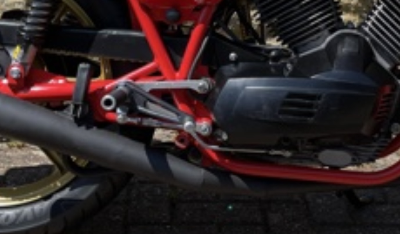

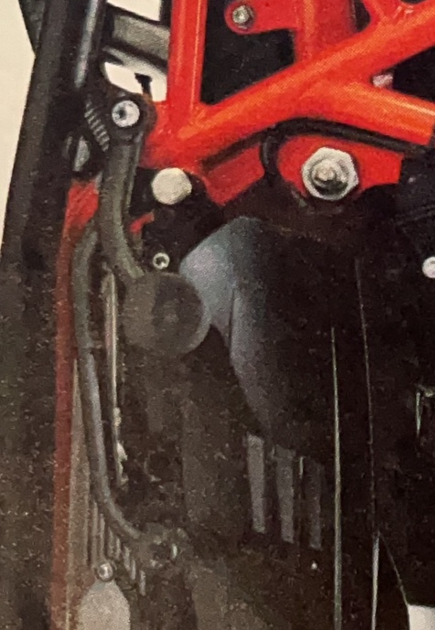

I’ve not got a decent picture of my k1 before I fitted rearsets but below is a picture from the sales brochure of the standard setup, and one of my bike now with rearsets and the longer cranked linkage
As above, I don’t believe there were any differences in the electric start case for the road models.

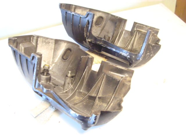

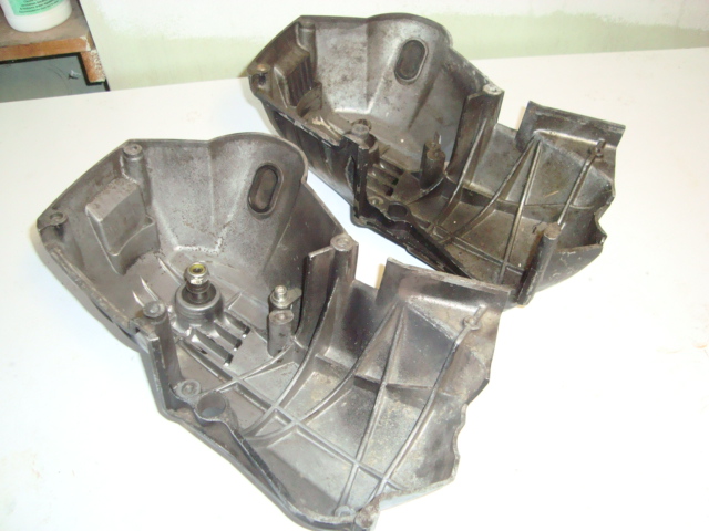

Trust this helps
Could alter the Excalibur cover?

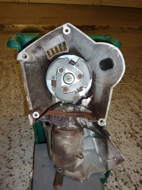

Thanks guys, the case I have looks like the camel one. I have been looking at pics of my old Morini K, the linkage looks the same but the casing I have is definitely deeper. So cutting back won't work, so the hunt for a roadster case continues.
Attached are pics of my old bikes one and the one I have.
