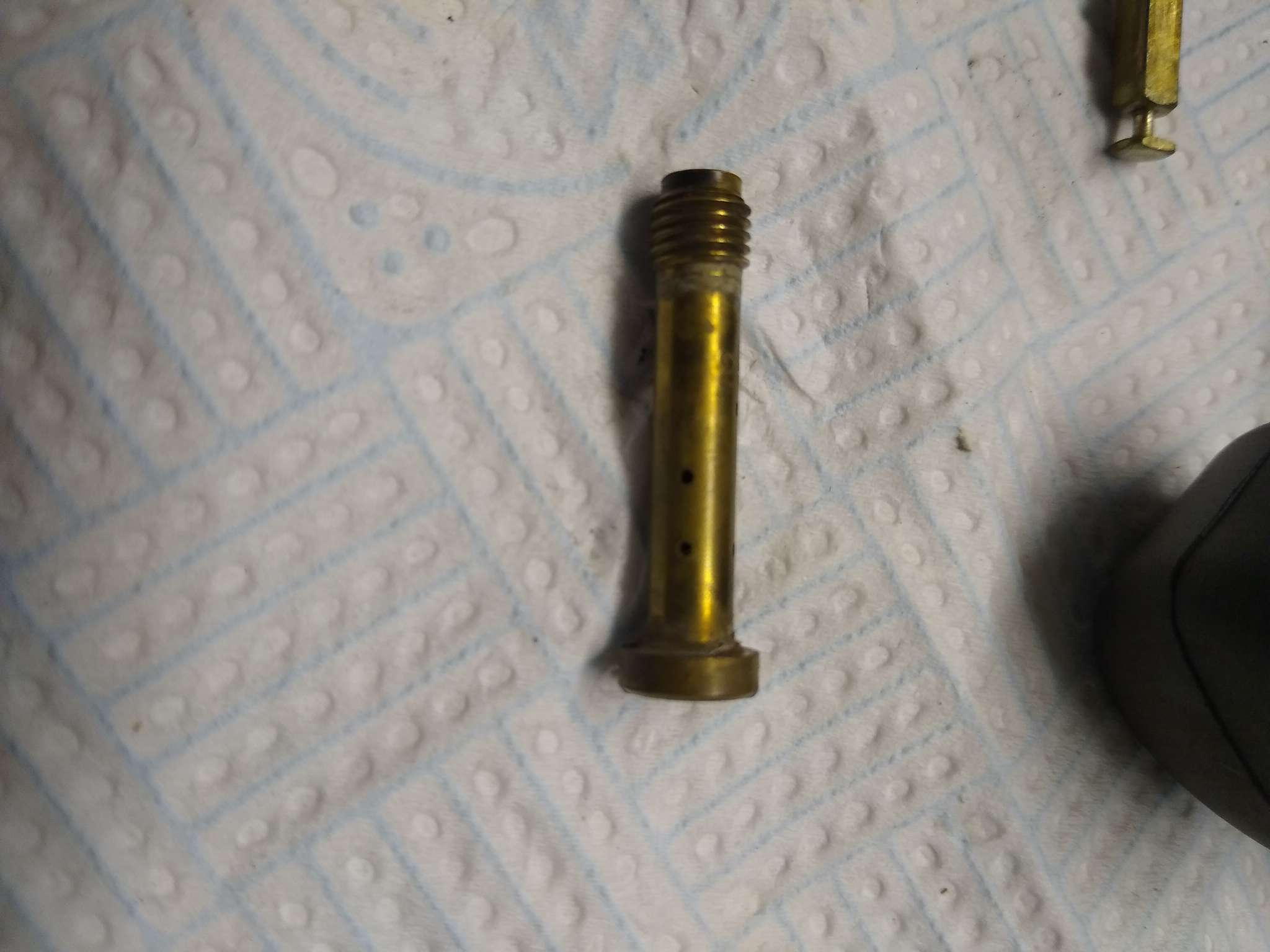

I have stripped the rear carb and spotted the atomiser is a 260D when it should be a 260K according to the blue book. It's also tarnished and corroded.
Going to order a pair of 260Ks and a pair of needles plus float needles which are worn. Anything else I should order.
1981 3 1/2 Strada

Right done a bit more reading I have VHBZ25HS carbs which have the vacuum pipe connecting the carbs.
If I understand it properly the HS carbs with vacuum connector have a 260D atomiser
The BS carbs without vacuum connector have a 260K atomiser.
I am buying new atomisers anyway but good job I checked
1981 3 1/2 Strada

260D atomisers seem to be unobtanium stumped now.
1981 3 1/2 Strada

Post by Fastmongrel »
260D atomiser seems to be unobtanium I might have to fit a 260K
