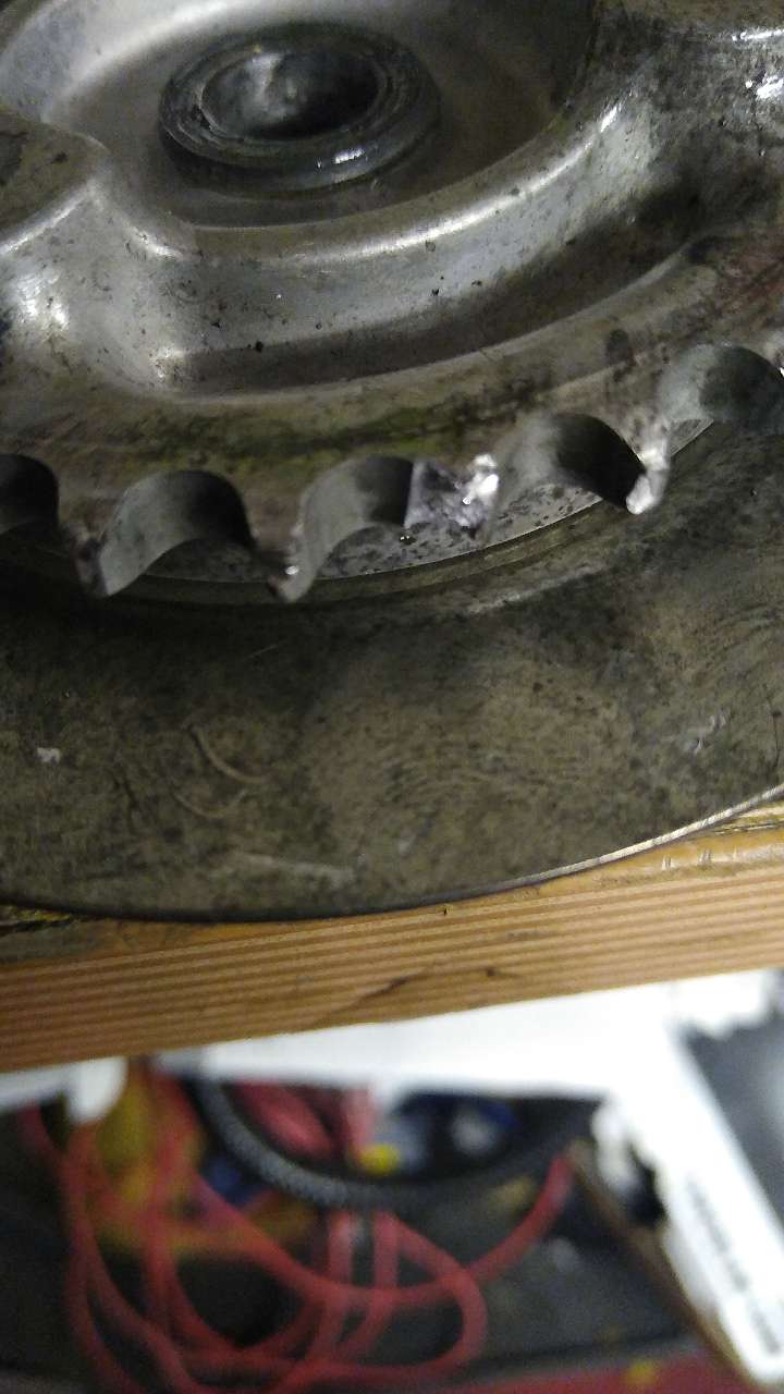

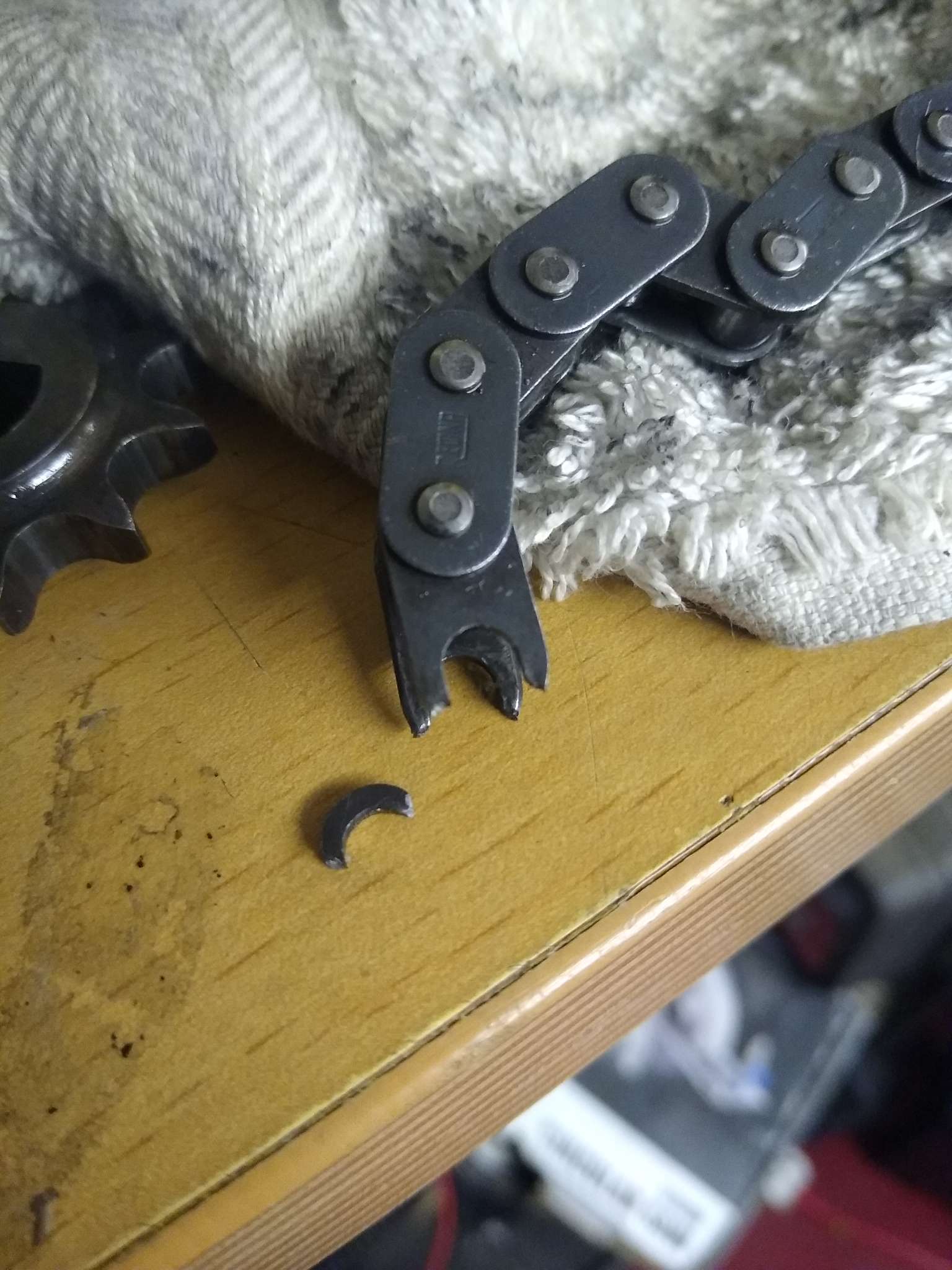

Out for a spin today dodging the wet patches on the road came to some lights and engine stopped (think I need to blow through the pilot jets) pressed starter button crunch clang whirr. Whirring noise but no turning engine.
Didn't fancy trying to start the engine just in case something nasty had happened so I pushed the last half mile home whipped off the casing and found the chain had snapped chewing up half a dozen teeth on the clutch and chipping 2 teeth on starter pinion.
I am guessing the chain is a standard size but I can't find the clutch or the starter motor pinion.

Hi, that's a bind! You're right about the chain being a standard size and I bought one at a local bearing shop. They could only supply with a split link which I have use but keep as a spare now. As for the sprockets, I would like to know if any way of replacing them is found too! I have a couple of damaged examples and even the intact ones I have are worn to the extent it's impossible to tension the chain.
So if any of you know how to replace these sprockets please speak up!

One question, do you know why the chain snapped?
Re: Starter motor chain snapped
I replaced my chain about 14 years ago. It was worn. I wonder if the chain snapped breaking the teeth of could a tooth have broken first? Either way it is a bit of a tricky situation.

No idea it could have been the original chain for all I know. Plenty of people have said they have had chains break.

Could be there must be a lot of torque from the electric motor especially as it has to turn the drive 90° which I have been told is never a good thing for electric motor. Basically a bodge straight from the factory.

I always leave slack in the chain, it is easy to havebit too tight. As John says, a tooth may have broken taking the chain with it, but looking at the chain, it appears the roller has pulled out through the end of the plates. It may have seized. I'll have a good look at mine next time the case is off. The chains are not lubricated.
As you say, a bodge from the factory.
