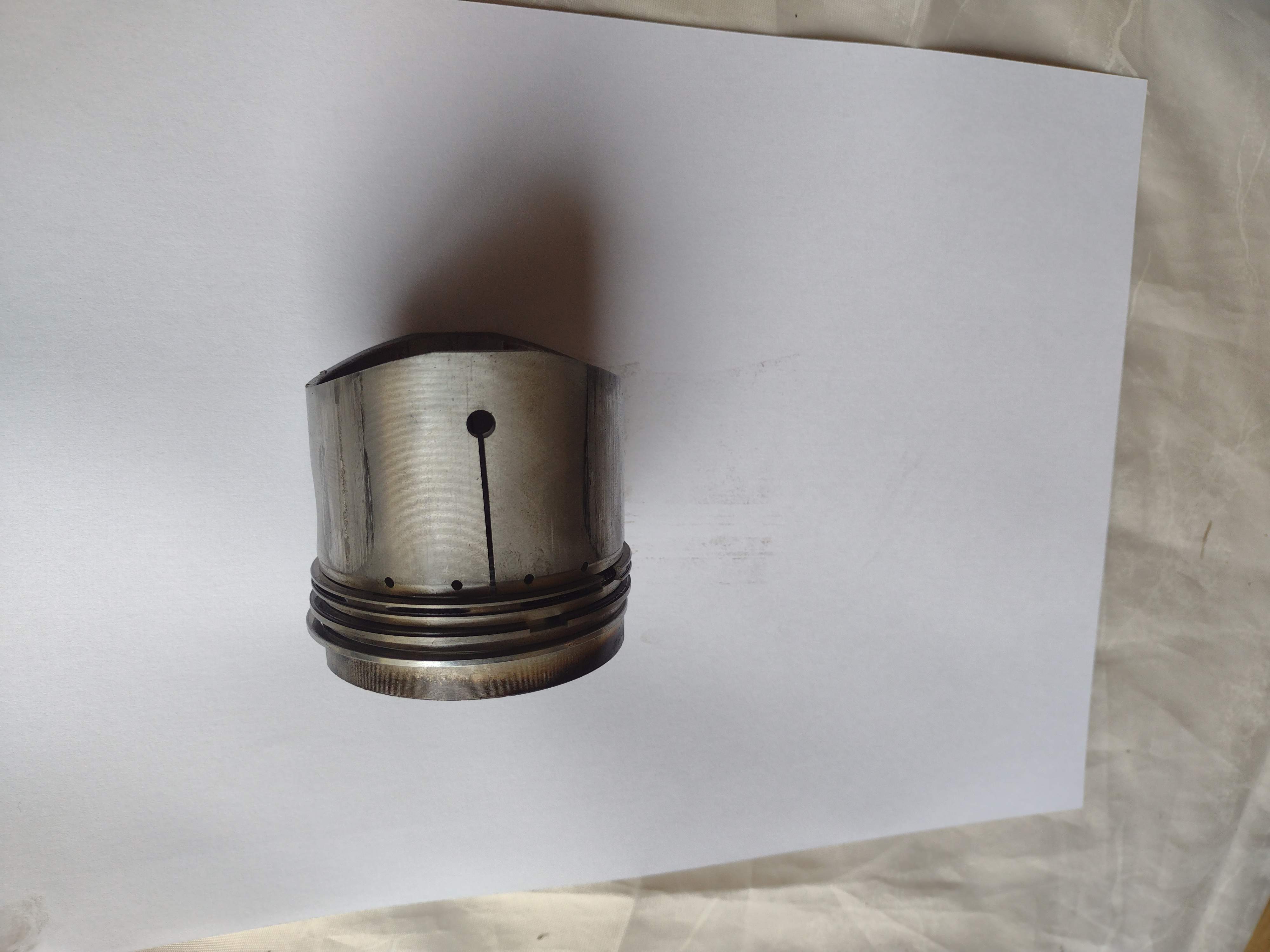

Those who followed my 'Forgotten Error' tale of the speed hill climb special may recall that on its first competitive outing at Loton Park I thought it seized. Then later I decided (as it ran again after rolling back down to the paddock) that the 'brick wall' effect was just massively rich main jets as this engine had a weird reground cam in it.
Well, the time has come to rebuild it again but with an L5 profile cam supplied by a regular on here. On removing the front cylinder in preparation for parting the cases I discovered two things.
1) As I lifted the cylinder a gugeon pin circlip fell out!
2) The piston bears witness to a fairly significant 'picking up' event. See photo.
These could be connected I suppose. I've put many a Morini piston on and never had a circlip pop out before. These are not OEM pistons of course and the clips were if anything too easy to fit having long 'ears'. I guess I didn't get it snug in its groove though.
I may take a swiss file to it in the traditional 'Tuning For Speed' manner, or I may end up swapping over the complete 375 top end (not just the very nice Kanguro heads). I treated that to new pistons on the last rebuild and the bores didn't seem very worn.
