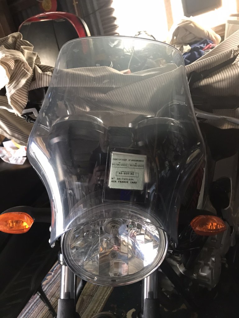

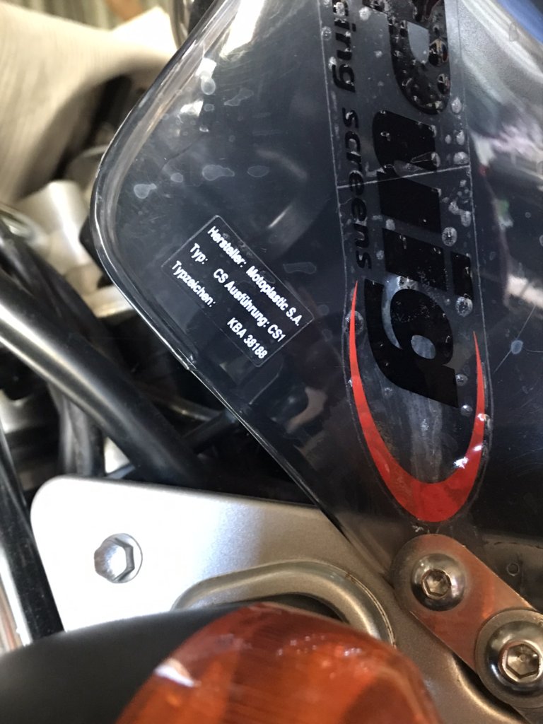

Hi, I have a Puig flyscreen fitted to a little Yamaha 250 which I find effective. The Yam headlight is 18cm OD, the screen 22cm at the mount points. It fits via the two headlamp mounting bolts. It's easy to fit, but be careful to ensure all mounting holes (for reinforcing plates and headlamp) are free and well aligned, to ensure no stress on the plastic. It's Type Number is KBA38188.

I might be able to find out - but that Puig looks *exactly* the same as my old one. I mean, exactly, down to the type of bolts I can see!

I’ve ordered that Puig one as fitted to the Yam, I also reckon if Daddy Dom thinks it’s exactly the job, well that’s good enough for me! Be 2-3 weeks as none in the country at present but I’ll report back when it materialises 👍
