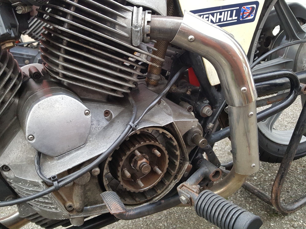

My alternative solution to the heat shield issue, albeit on a 2:1 system on a 350 in a 250, is two lengths of stainless exhaust split lengthways. One came as a nearly perfect 'bend'. Held on with screws in to stainless jubilee clips. Crude, perhaps, but effective.

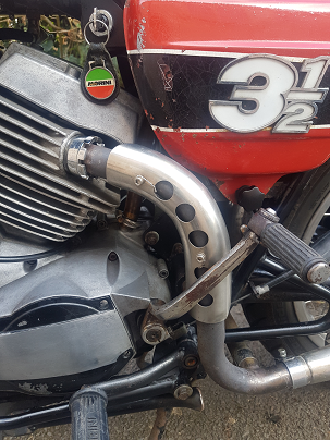

This heatshield was made for the MRC club strada by Paul Compton by slitting a stainless pipe with the appropriate bend
the holes were added by Benjy Straw. I think Paul has a youtube video showing how he did it. https://www.youtube.com/user/EVguru

Yes, I was anticipating that I may have to fabricate a heatshield and had viewed Paul's solution on youtube. I will keep an eye open for a piece of suitably bent pipe!
