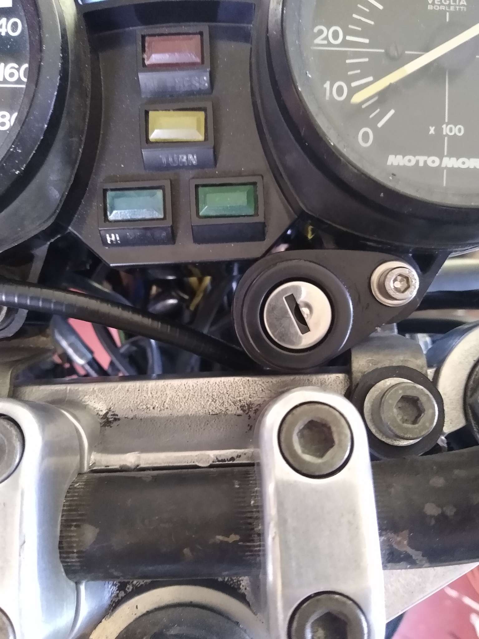

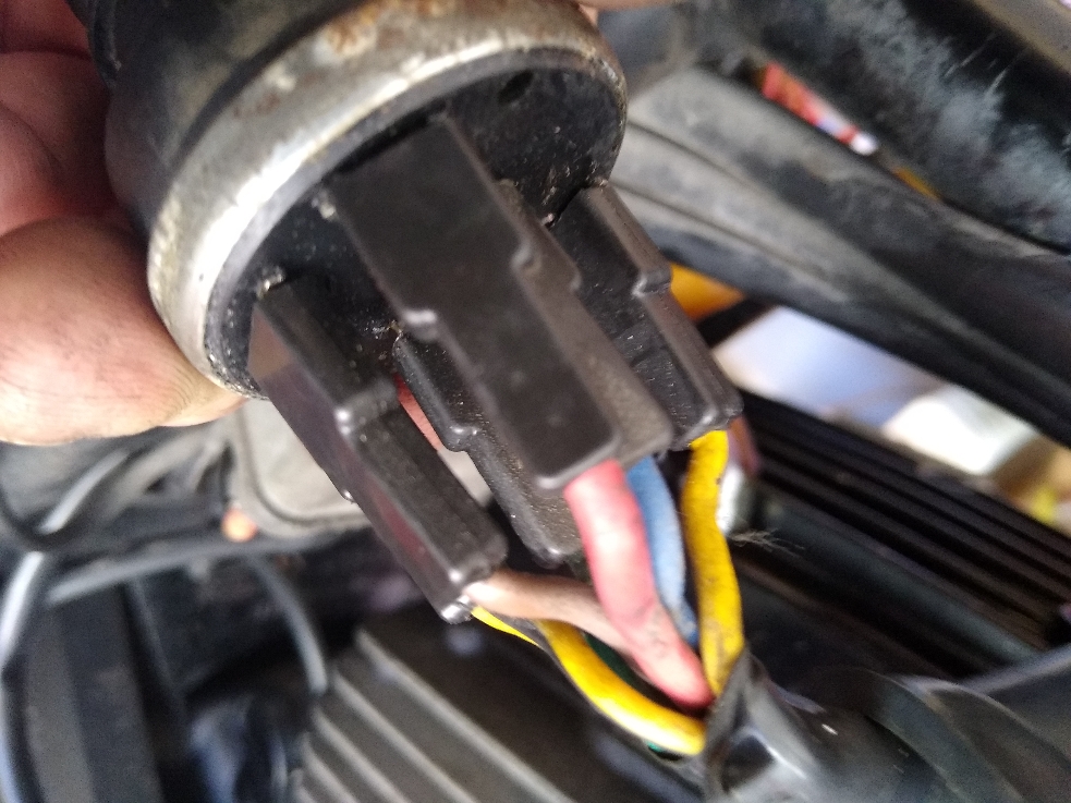

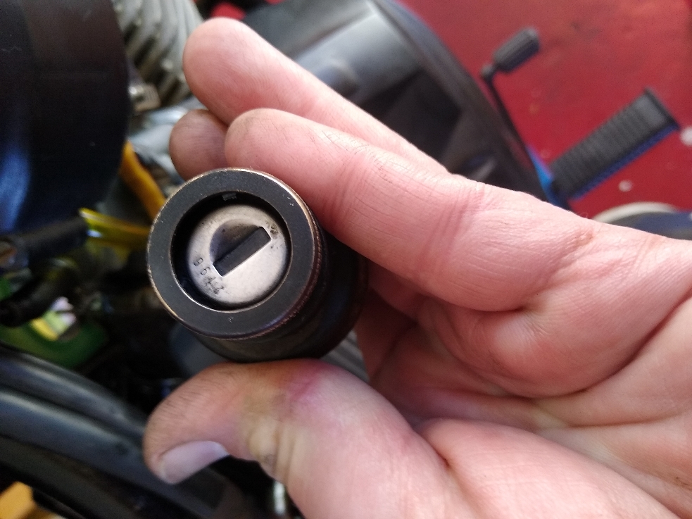

The key in my Strada doesn't lock in place. Found this out on Sunday when I caught the key halfway to freedom.
Barrel has 6 connections on the back do I need to find a 6 connections replacement or can I do without some wires I don't care about a parking position

I think you will need a 6 wire one. From memory the switch connects the side lights for normal riding as well as parking.
Have known to be wrong though.

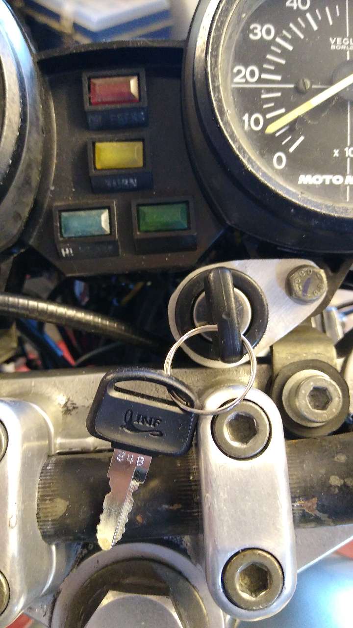

I am going to see if I can fit the ignition switch up front and visible while riding there's a space between the clocks and handlebars or maybe to the headlamp shell. It's not a genuine Morini headlight so don't mind a bit of plastic surgery.

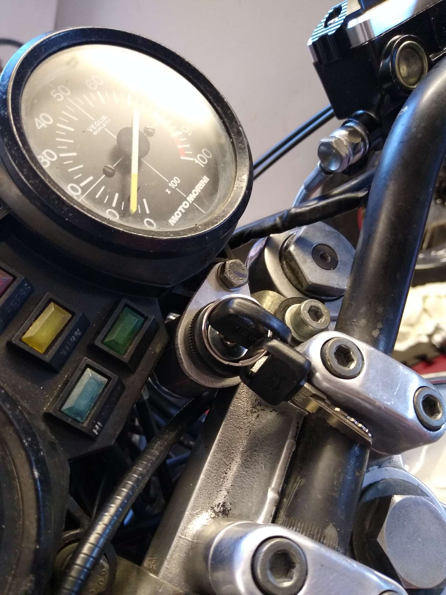

New ignition switch and a half finished bracket to attach to the clock mount. Need to make up wiring to attach to the original ignition switch harness so it can be put back to original if wanted

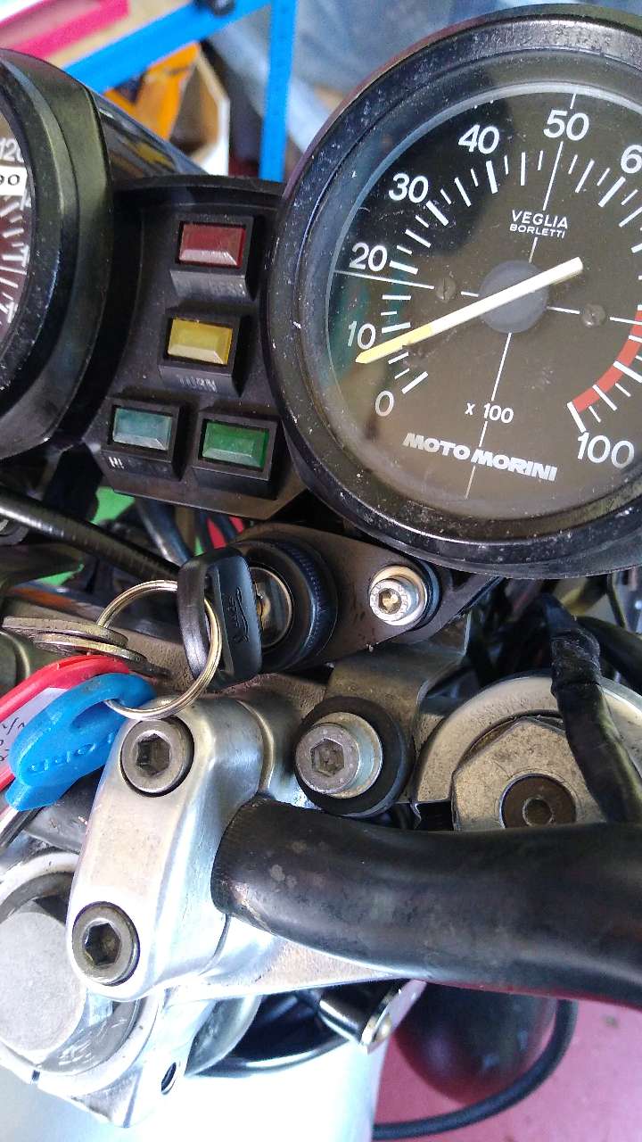

I have fitted the ignition switch to the right so that it doesn't foul the clutch cable. I wanted to fit it centrally but there isn't any room.
1981 3 1/2 Strada

Looks neat. :D

RedVee wrote: 13 May 2023 08:09Looks neat. :D
Thanks it luckily just fits. I have put a sleeve cut from a mountain bike inner tube on the body so hopefully it shouldn't rub against anything or rattle. I am making the wiring now I was thinking of colour matching to the original wires but then I found out how much wire costs these days so it's all going to be green with masking tape labels.

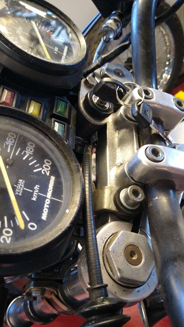

All done looking quite good pleased with myself 😄

Neat solution.
I’m sure you know, but make very sure you include a diode in your wiring extension loom on the (actual) green wire.
This is to prevent a fault in the ignition switch putting battery voltage onto the green wire supplying the transducer, which will kill your transducers.
If it were me I would fit the diode at the fusebox end (like the original should have been) as this will also protect your transducers if ever your new wires got mis-connected or damaged.
