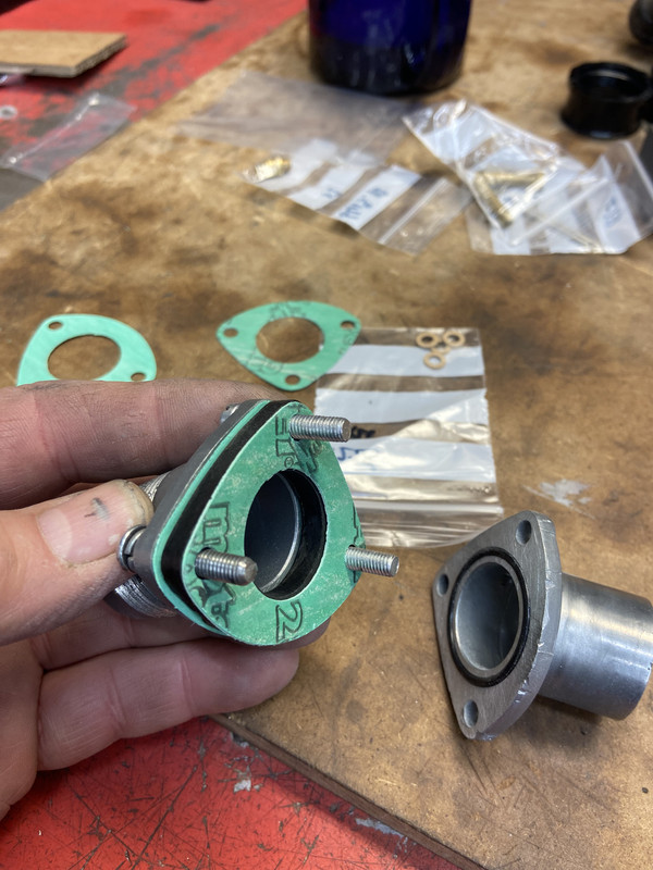

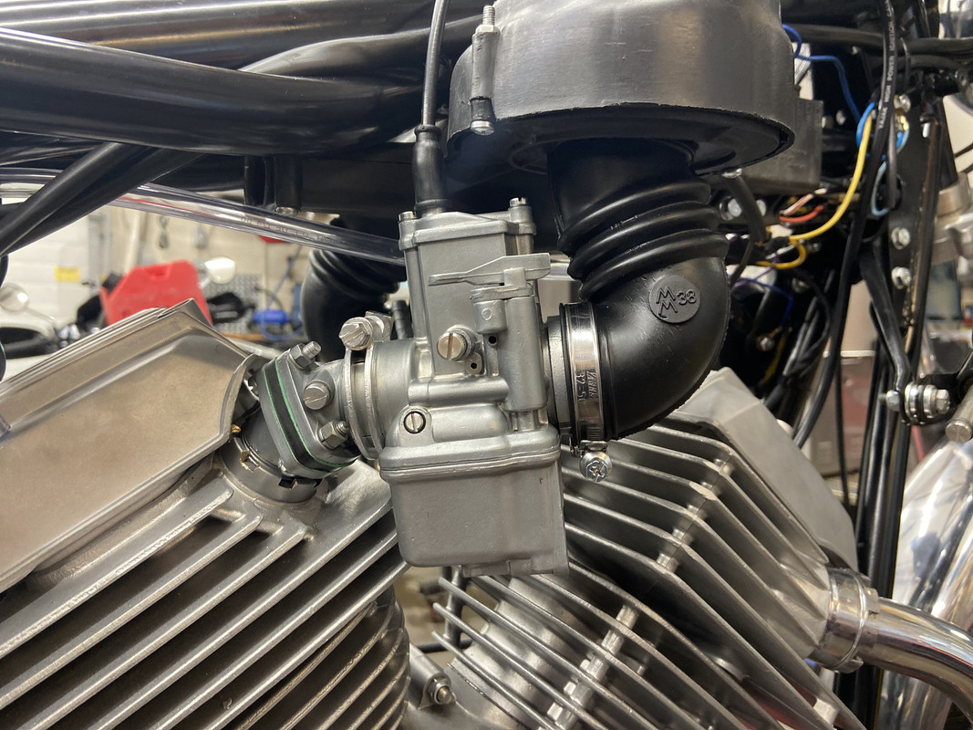

I got all the carb parts from Eurocarb and Mdina Italy today, all back together now, thanks again for the links

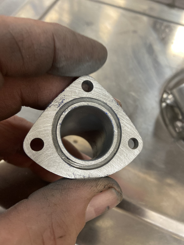

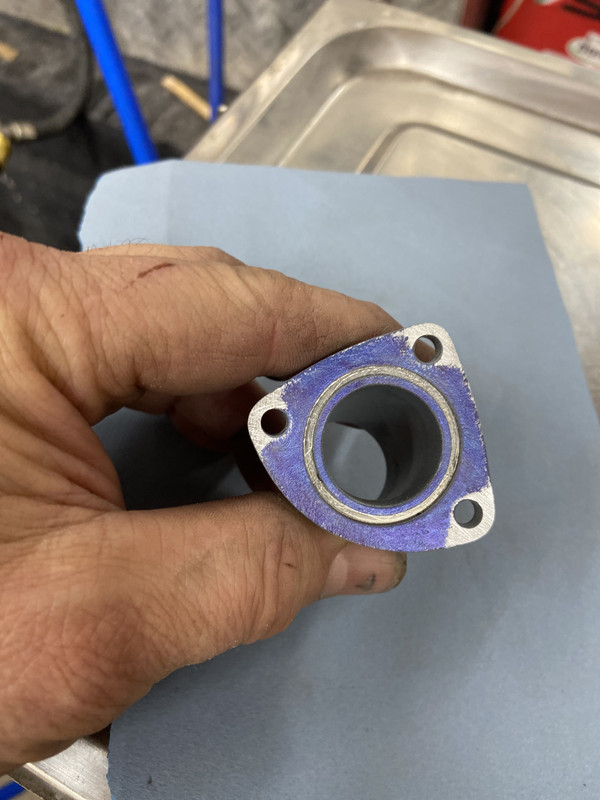

I found the aluminum manifold mating surfaces to be quite warped, I flat sanded them on glass with 200 grit
talk about belt and suspenders two gaskets, two O rings and an insulator
Anyways the carbs are fully rebuilt with new jets, atomizer, needle and fuel needle plus rubber boots to air filter, hopefully the bike will run right
