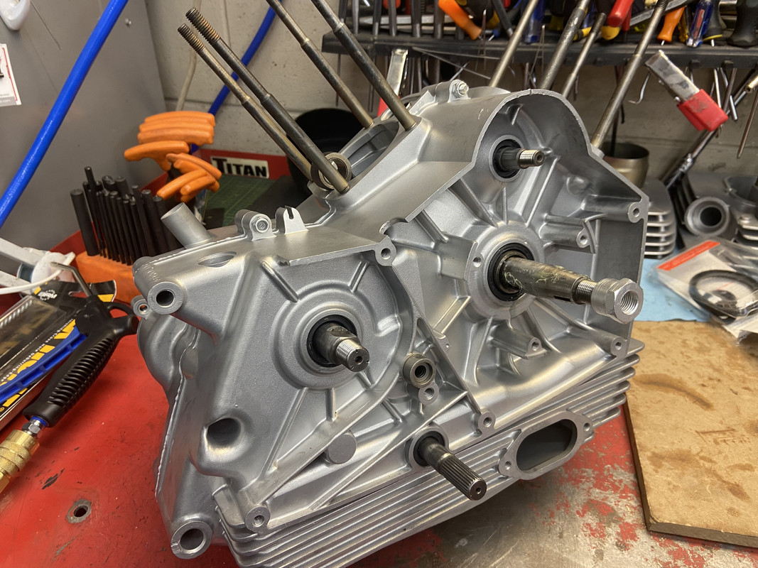

Regarding the oil seals in the right hand crankcase. Are they just pressed in, or do they require some sort of adhesive?

By no means am I an expert as only done this twice in eleven years on a Morini but I have never done anything other than get then in square and level. I have fitted oil seals to many other bikes and follow the same technique. I have only recently obtained some proper seal drivers and have just used a socket or tapped the new one in using the old seal for the past 48 years.
If there was a witness mark or wear ridge on a shaft it is good to try and align the seal to it.
If the seal was a loose fit then I guess some suitable adhesive would have to be used ? Loctite 603/542 perhaps.

Normaly you won´t need any adhesive, just puting the seals without damagin them in place.

Most of the seals fit 2mm below the case and really needs a special tool to get it right. I use my eye! The gear change one has a stop at the back and is simple...

If you apply a very thin layer of Black Silicone sealant on the side face of the seal it will press in very easly with your fingers, just wipe off any extra silicone after the seal is set in place, the very thin layer of silicone will alos fill any nicks in the casting surface
grease up all the shafts before joining the cases
