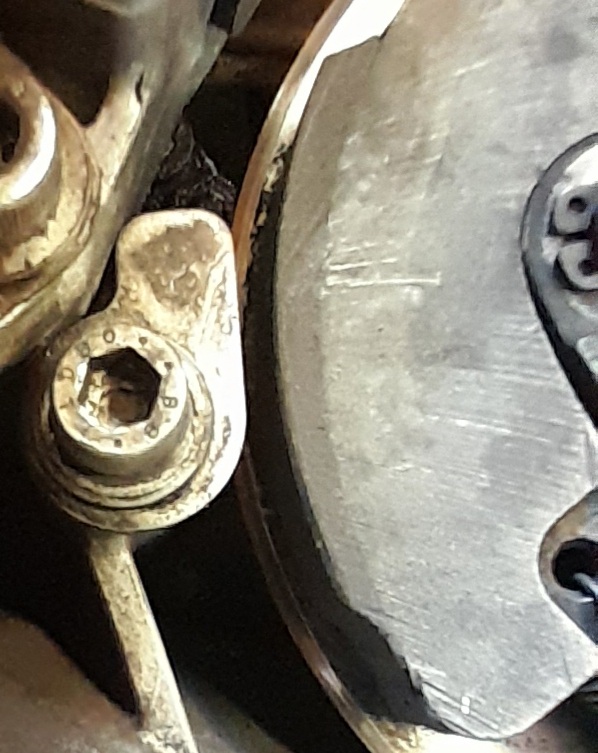

Posted: 03 Nov 2021 12:39
by Syko
OK!
- shoes spin and flail out. Is there enough'meat' for them to grab the flywheel?
- what's this ('loose') tab for?

Posted: 03 Nov 2021 13:07
by EVguru
It's an eccentric stop to help set the chain tension.

Posted: 03 Nov 2021 16:40
by Syko
EVguru wrote: 03 Nov 2021 13:07 It's an eccentric stop to help set the chain tension.
How does it work, and why is it loose? ( bolt done up tight)

Re: Electric start
Posted: 03 Nov 2021 16:56
by Steve Brown
Syko wrote: 03 Nov 2021 16:40
You probably have the wrong screw (too long) or the threaded hole is bunged up with debris. The cam thing should be held in place when the screw is tightened. You can get away without it though!
