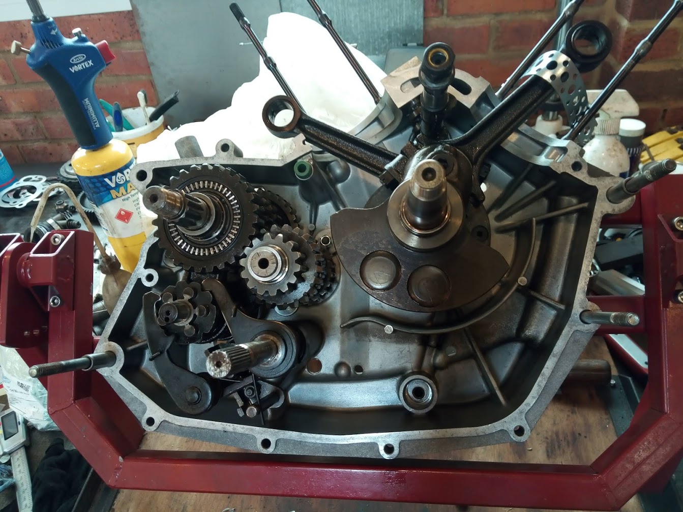

The socket head goes on the "wet" side with a copper washer under it and the nut goes in a hexagonal recess on the "dry" side.
Late engines use a rubber seal between the case halves (same seal as the oil pump feed) for the uppermost internal bolt.
- cases.jpg (279.11 KiB) Viewed 6473 times

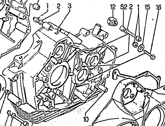

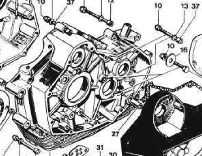

OK, I had to go and check and it appears Morini may indeed have changed their mind about which way the bolts go through.
One of the dry side recesses on the 500 Sei cases in my picture has a hex recess, but the other one doesn't. The clear hex recesses are on the wet side.
The drawings on the parts microfiche differ. Early ones show the bolt heads on the wet side, but later ones on the dry side.
They may have changed it just for ease of assembly. I can recall having problems getting the nut to sit in the hex recess.
In any orientation, I'd have the copper washer under the head of the bolt.
