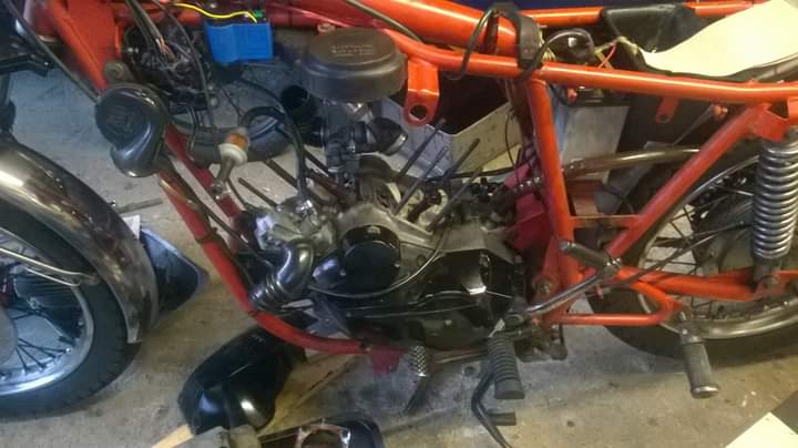

I'm more used to working on 500 engines, where I KNOW the engine has to come out to remove the rear barrel.
You know what's coming...there's no way to get the 350 rear pot on, with the engine in the 350 frame? It seems to foul the ign. Switch bracket at best. It might be possible by removing the front offside cylinder stud of the rear assembly and slipping the barrel in and up? Anyone do/done this?
Failing that it's a chain off again engine out, pot on, and manhandling a suddenly heavier engine back in without scratching the new frame paint

Thanks guys. Ive tried 'rolling' the cylinder onto the studs, definitely not enough clearance and it's the ignition switch frame-bracket that fouls the pot, not the switch itself which is removed for clearance. On the 500 the bracket is removable
I will try taking out all but one rear engine-bolt 'pivot' , to tilt the engine forward, a la Ducati Bevels, as a last resort. Loath to start removing barrel studs that have never come out, but I have a stud-gripping extractor and a hot-air gun so may not be too painful for the crankcases

GHF wrote: 05 Apr 2021 07:26 You can do it.
The ignition switch bracket is in a more sensible place on your later bike, in the photo. On the early 350s, its makes a triangulated 'corner-bracket' right where your ignition switch wires are touching the frame in your photo, just where the rear cylinder is angled towards!

Ming wrote: 05 Apr 2021 06:44 Might be worth having a look at some of 72Degrees' posts on his Hill-Climber. He may describe something similar on a 350 engine in a 250 frame.
Ah, found it, thanks Ming. 72 Deg managed, by drooping the engine down at the front using just one rear engine bolt as a pivot, which was going to be my next/last resort experiment!

So, car-jack under the sump, remove all but the lower rear engine bolt, as a pivot. Padding on downtubes and frame rails. Remove oil filter and cover for clearance, and gently let the jack down. Engine arcs forward and down.
Rear cylinder goes on with plenty of room, just like a D*c*ti bevel twin.
