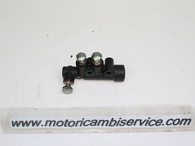

You might be lucky and find someone who has an unmodified 500/K1/K2 and can photograph the splitter, but I seem to remember it was a 'generic' sort of part used on many bikes of the period, like this:
- s-l400 (1).jpg (11.4 KiB) Viewed 8724 times
It was attached across the bike, to the underside of the yoke by an angled bracket.

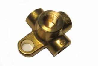

If you want to place a stoplight switch as well you have to look for this. It should be awailable at allmost all hydraulic (brake) shops.
