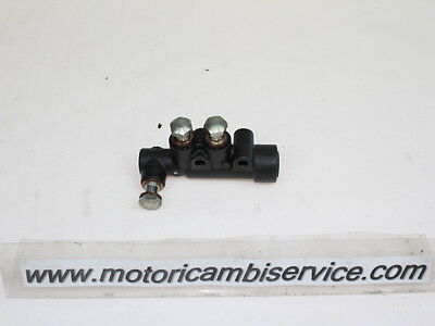

You might be lucky and find someone who has an unmodified 500/K1/K2 and can photograph the splitter, but I seem to remember it was a 'generic' sort of part used on many bikes of the period, like this:
s-l400 (1).jpg (11.4 KiB) Viewed 8586 times
It was attached across the bike, to the underside of the yoke by an angled bracket.
George.

Post by Mark »
Ah yes, I can see how that would work.
Thanks for the photo.
I’m wondering why a 2 into I arrangement would be used rather than just running 2 lines.

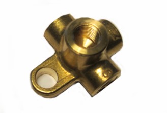

Posts: 928
Re: Bottom yoke holes thread size.
If you want to place a stoplight switch as well you have to look for this. It should be awailable at allmost all hydraulic (brake) shops.
4fachm10x1 Verteiler.jpg (9.79 KiB) Viewed 8511 times
