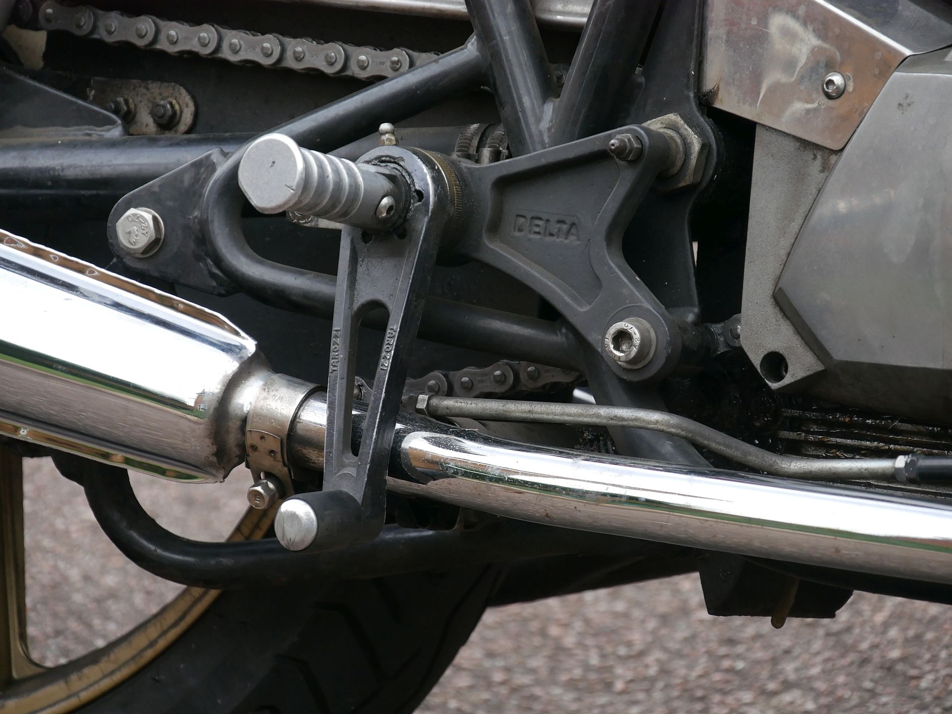

Hi All,
Went for a thrash, sorry ride, today and as I was nearing home felt the gear selection was sloppy, and neutral was elusive.
Just 1/4 mile from home, in 5th gear, went to change down but there wasn't a gear lever under my foot! The nyloc nut had disappeared from the bolt through the linkage rose joint...Thank goodness it is a tractable engine with a forgiving clutch!
Lesson learned: It's not just my Norton that shakes things loose such that you do a walk around after each ride to check it is ok. Remember to tighten your nuts regularly!
Regards,
George.

That happened to me last year, fortunately I was approaching a roundabout and I felt it fall off as I changed down. I was able to pull in and retrieve it (still intact!) and ride home with my toe against it.
