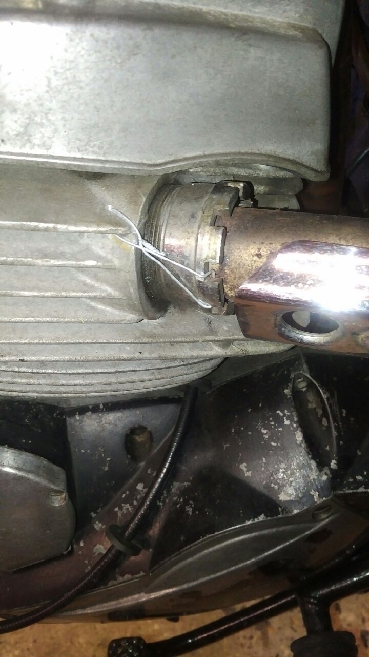

As I was riding home from the Corsaro section gathering in Alton last weekend my 350 sport became very loud as I rode up the A3. I was just a mile from home so rode back.
Once home the reason for the noise was obvious, as the castle nut on the front exhaust was sitting on the down pipe near my toes. This was wired when I bought the bike though the other wasn't, I had been regularly checking the other but assumed that all would be well on the wired side. Clearly not as the wire had slid down the pipe too!
Nut is chewed up but I can get it tightened easily, so I assume the threads are fine. I just need to know what I have lost and where to buy replacements as the pipe is very loose now with the castle nut tightened and certainly is not making any seal there either.

Probably the two half collets that holds the nut on the pipe. Do you still have the gasket?

As Mike says, the half collets. Trouble is they come in about 3 or 4 variations! The shape and dimensions of the flange on the end of the pipe determine which you'll need. If you can post a pic (I never can) or a drawing with dimensions of the pipe it will make things easier.

by bizzywizzy
Here are the pictures.
I think the gasket is still there, so I think all I need are the 2 half collets.

Right, the flange on the end, how thick is it? Some pipes are thin there, just the pipe itself flared out. Others are around 3mm thick, a collar welded I think to the pipe.
If you can get the thickness of that flange it will help.

With many thanks to George 350 I now have the collets and a fully functioning front exhaust! I now need help to source a pair of half rings that fit the "square" section flange to replace the ones George sent to me today. Any leads on finding replacements welcomed.
