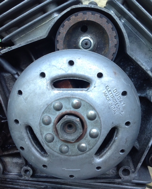

Thanks for all your other replies on this. Looking at my flywheel it looks different to many others I have seen (see pic), with 3 slots rather than holes that would usually take a tool/holder. Says Ducati on it. Anyway it was rebuilt when I bought it 20 years ago by the late Phil Smith, and he changed my cambelt a couple of times so am sure it is right. However should I then be using the slots as the pin holes if I can fashion up some kind of holder (have searched for the special tool but to no avail - they appear to be like gold dust)? Otherwise am guessing am gonna have to shell out for an electric wrench thing. Thanks

If making a holder the slots or the smaller holes near the edge will suffice, but as Norbert said above, you can normally do this by engaging top gear and applying the rear brake while you undo the nut. I managed for years before I started splashing out on tools
