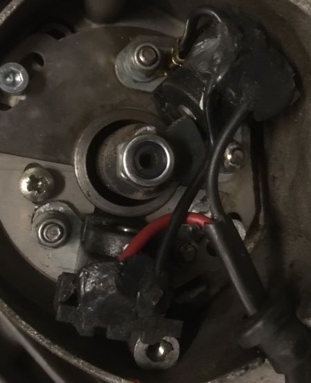

I would like to ask a favour,
could anybody post some pictures of an NLM pick-up please?
Thank you ,
Paolo
Thank you ,
Paolo
Re: NLM Ignition
not good at uploading photos... hope this is clear enough
- NLM2.jpg (29.25 KiB) Viewed 12444 times
