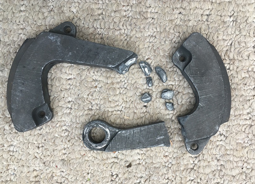

So I pulled the housing off and found the problem.
Everything was moving smoothly and properly in place when I put it together. The circlips and washers were all still there and all the springs in place when I took it apart. I unhooked it before taking the photo
The fragments are rounded on the edges, presumably where they were rattling around in the flywheel
Reckon I'll be needing some new starter shoes. A good thing it fires up easily enough when kick staring.

I think the metal is some sort of zinc alloy.That design was updated at some point to a more substantial shoe on a steel backing. I got a set of these “later” shoes which improved the starter action ( finally optimised by rebuilding the gearbox, fitting a new brush holder assembly etc new chain and a new Odyssey-like battery.)
At least the metal did not make it through to the other side of the rotor.

Looks like you caught it before anything else got damaged. Are the shoes in the pic the earlier type then? And are the steel laminated shoes the later, heavier type? I get mixed up sometimes see...
