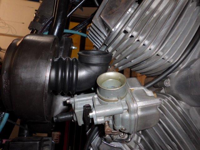

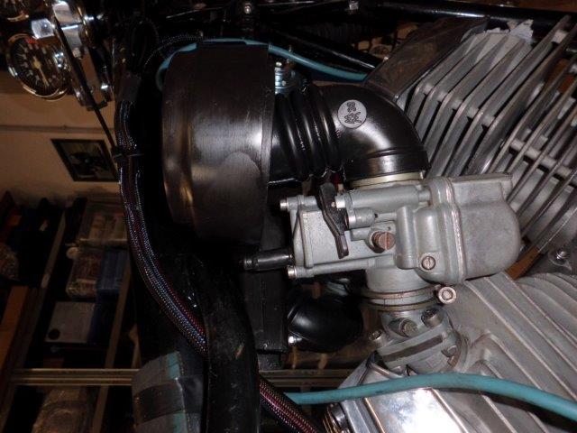

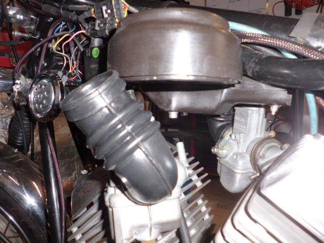

Hi All,
I have been following this thread with interest as I seem to be having great difficulty re-fitting a standard airbox. I bought a replica GRP unit from NLM many years ago with a set of rubber connectors, when I tried to fit them one of the rubbers split and the whole lot went in a box for another day. I am now refreshing my 1976 3 1/2 Strada and decided to dump the pod filters and weird jetting (didn't match any set-up I could find) and return to normality. I ordered a pair of connecting tubes from MDINA and on fitting the carbs and air box I hit a problem, the connecting tube on the LH/front carb appears to be too short or the wrong shape. The other possibility is that I have naffed it up somehow. I have looked at the manifolds on https://www.startgomma.com/en/moto-mori ... ifold-v521 and they appear to be different lengths, is that correct?
I have attached some photos of my current set-up for reference/ridicule as required. Any help will be appreciated.
- CIMG0065.jpg (52.56 KiB) Viewed 9543 times
- CIMG0064.jpg (56.89 KiB) Viewed 9543 times
- CIMG0063.jpg (50.61 KiB) Viewed 9543 times
Re: Carb to Head Rubber Manifolds
Hi
With the original two piece manifold they will need to be rotated unscrewed to move the carburettor towards the centre of the bike this will reduce the required length of the elbow. It's quite a fiddle to get everything aligned but you need to do this before tightening the ring nut on the manifold.
Typically this means that the manifold does not bottom out in the head so it is secured by the ring nut.
The carbs should be vertical when viewed from behind.
Hope this helps
Hope this helps
Cheers Mark,
That sounds like a good place to start.
Will adjusting the elbow length (I guess by screwing it in or out) alter the position of the vacuum gauge attachment point or do I need to dismantle the triangular flange as well to get the best alignment?
I'm sorry for all the questions, it just saves on the `Oh, now I see' moments.
- Posts: 1678
You will only need to twist the inlet stubs a few degrees to alter the alignment. So start with them fully home and then back them out a little to get the angle right as Mark says. The carb will move up and across quite a way with a small movement of the inlet stubs.
Hi All,
Thanks for the advice, it all makes perfect sense after the fact. Every thing is now aligned so I will stick with the MDINA rubbers for now and if they fail I will switch to Startgomma. It is great to find a supplier of quality Morini MDINA parts in Italy (it shouldn't be a surprise really) as now we are post BREXIT, MDINA postal charges are way out of my league; as with my last order, were 50% of the total cost, I will have to save up for a big order in future.
Hopefully I will have the re-build completed by the time Italy comes out of lock-down, which doesn't look like any time soon as the inoculation process is pitifully slow and a bureaucratic even on a good day.
