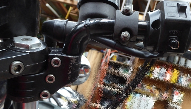

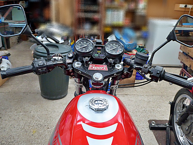

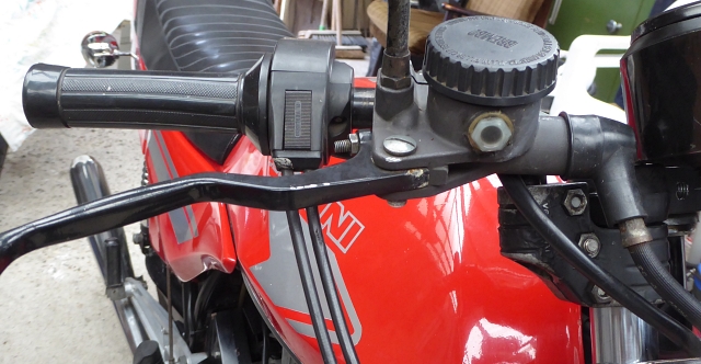

Aye Steve,
Images of the Verlicchi clip-on swan neck bars fitted to my 1986 K2 as 'original fitments' by Cagiva. Hope that this will help?
My regards, Bill
Rear close-up view of Verlicchi clip-on swan neck bar fitted to a 1986 K2.
Front close-up view of Verlicchi clip-on swan neck bar fitted to a 1986 K2.
Rear view of Verlicchi clip-on swan neck bars fitted to a 1986 K2.

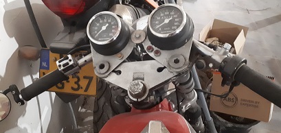

i fitted clipons from a guzzi le mans, fits nicely , and makes for a comfortabe riding position
morini 350.jpg (36.87 KiB) Viewed 13775 times

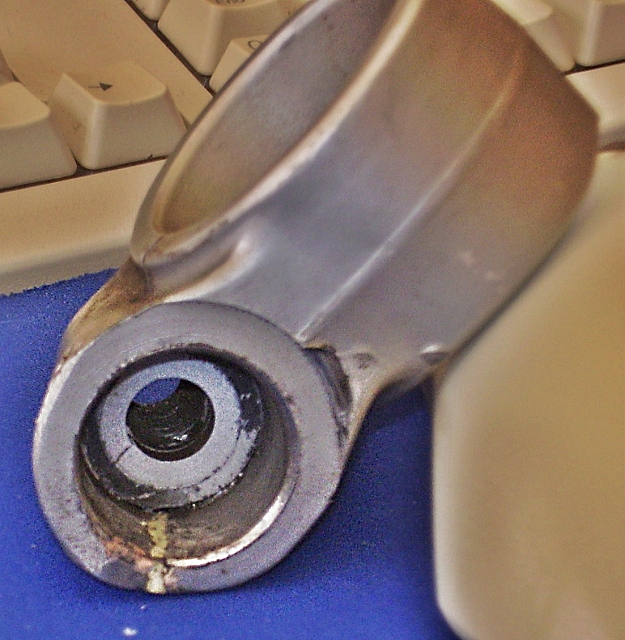

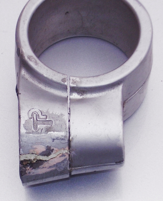

Tarozzi bars are the same as those fitted to the MZ Skorpion, one of which I used to own. Just be aware that the aluminium casting between the fork leg and the bar can fail and be "repaired"! :evil: :evil:
Body filler under a coat of primer and silver top coat! :evil: I have no idea when, where or how the fracture in the casting occured, but I wouldn't recommend the repair that I found!
My regards, Bill
Tarozzi handlebar casting failure 2
Tarozzi handlebar casting failure 1
