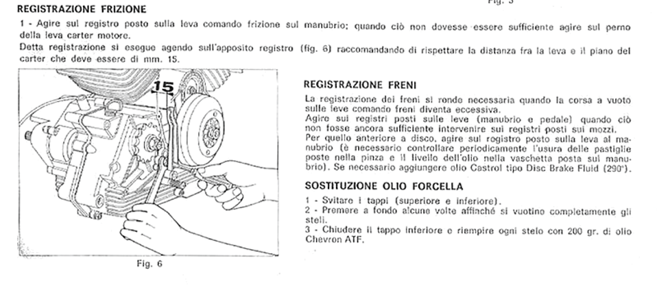

have the four rods and the last small rod only sticks out 6 mm so when I pull the lever the arm makes contact with the chain. All parts are new from NLM. I’ve heard some engines had a ball between the rods is this so.
Not this one assuming engine is approx correct for 1978 i.e 12XXX to 16XXX.
You should adjust the clutch operating arm so that it is 15mm from the engine case at the upper part.
This is shown in the workshop manual or owners manual.
If you cannot make this adjustment and the clutch work. Please come back to the forum.
