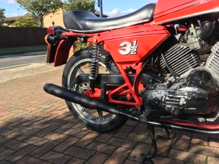

Finally cut off the extension pipe and fitted the Armours silencers. They fitted the standard brackets perfectly although I did have to slim down the nuts so they would slide into the brackets welded onto the silencers. I also had to run a drill bit through the clamp which is integral to the silencers so that I could get an m6 bolt through. Overall an easy enough fit.
They look good too and have a lovely sound, the engine seems to run better too but that may be the clean and refurb of the carbs.
