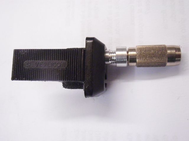

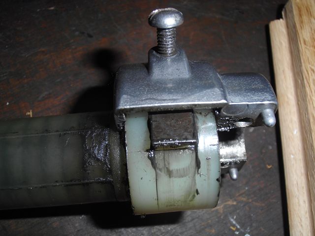

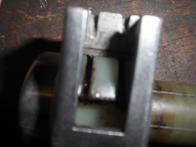

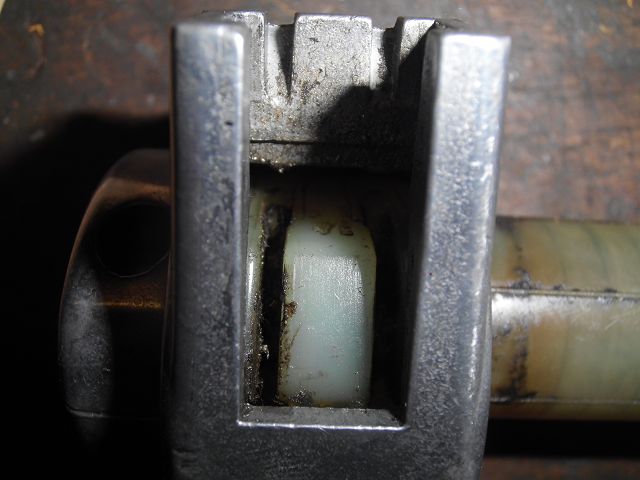

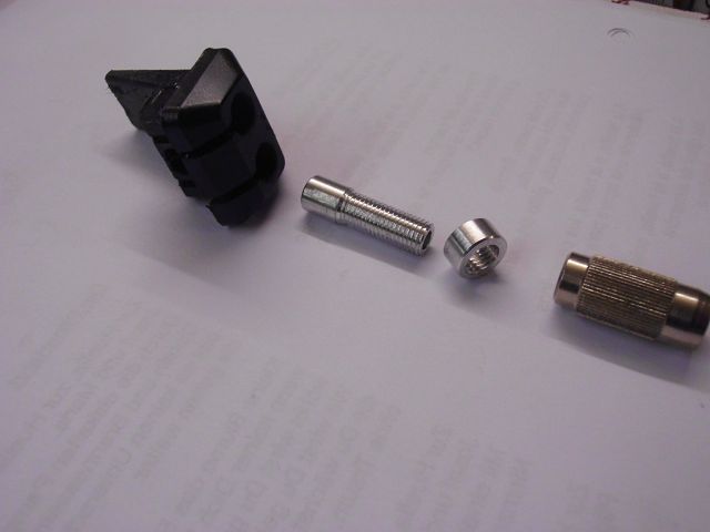

Here come the fotos as promised. I´ve found an old alloy throttle from Verlicchi, don´t know wether you have the modern plastic one.
The first foto shows the trottle nearly closed and the second one withe the throttle closed. That means the white plastic barrel, where the cables are attached stops at the alloy housing. This will be the same with the plastic housing. There is nothing more that stops the turning when closing the gas. The nipples only can get out, when the inner cables are too long, after mounting the black plastic part from the pictures above.
I´m not sure if the small metal sheet only exist in the older alloy ones, but I think so. With the scew, you can see, you can put some presure on the throttle making it mor easy or more firmly (till that moment that you have an autopilot, so that the gas will not return to idle when taking the hand off)
