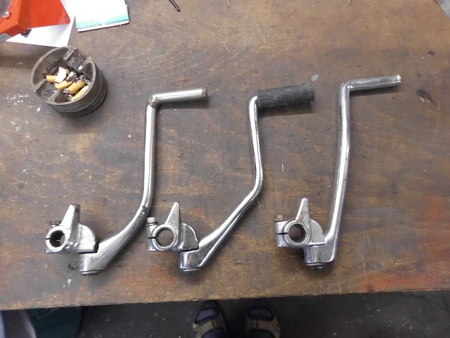

loking at issues with fitting rearsets noticed the folding footpeg idea to avoid kickstart hitting brake pedal what model kawasaki were they fitted to, also while iam on the subject does the kickstart extender block always have to be used when tarrozis are fitted still pondering the move, any help appreciated.

The smartest way is to look for a K2 kicker. They are made of steel and you can bend them with heat :wink:
If I remember it well, the left one is an original K2, in the middle a modified one for rearsets. The right one probably comes from a 250 (T or V2?) and is a bit weaker as you can see. But maybe it´s worth a try to bend it als well and attach a bit of material by welding.

thanks for photo norbet , good info, keeping options open what to do for best ,the folding footpeg is good idea still not sure what bike they were fitted on , kawasaki dirt bike i read , any help on this welcome. thanks muller.
